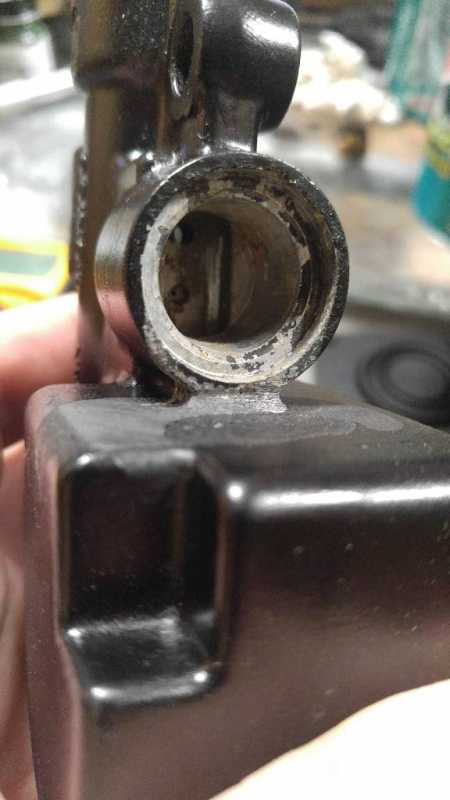

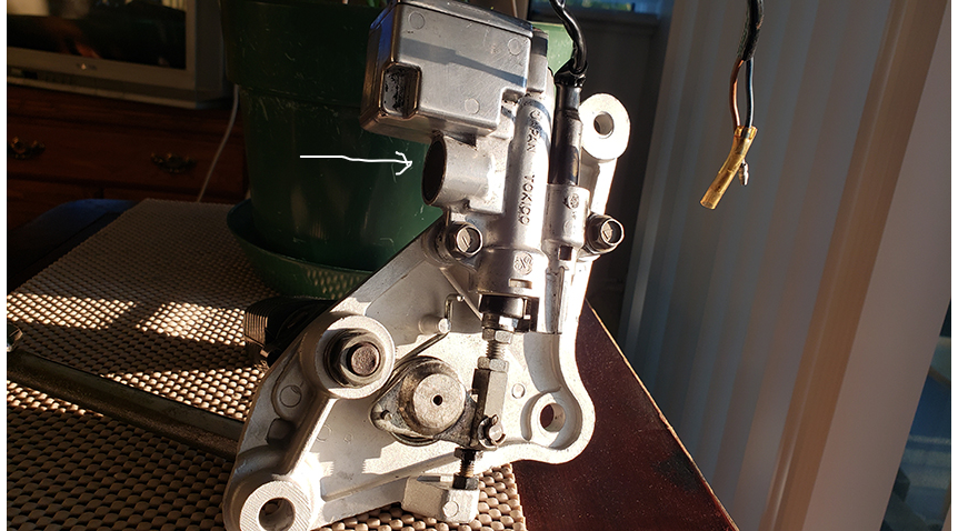

There are 2 holes but not obvious because they are hidden behind a black plastic plug. The holes could be cleaned or checked from the bore of the piston with a 90 degree piece of wire and flushing with probably lacquer thinner. See pics
This pic shows the location of the plug. They had to have a place to machine the 2 holes in to the piston bore then plug.
This shows the inside of that cavity with the plug removed.
I pulled these pics from a thread back on June 17 2019 thanks to Lucien Harpress for the post. He learned the hard way what happens to plastic plugs that you don't know about when you refinish your rear master cylinder with caliper paint and bake cure @ 200 F. Ooops

Thanks, I'll have to check my rear cylinder now. Yes I saw the picture of the melted plastic plug.
