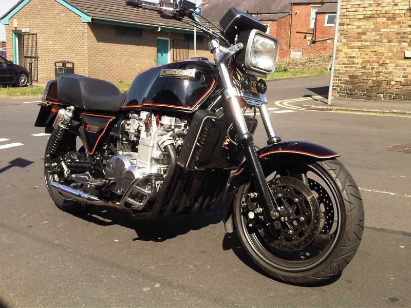

I am not sure which floating disc (if any) will fit the standard 1300 front wheel as I dont have a standard wheel fitted to my bike.
There will be one out there somewhere that will fit I am sure.
I always upgrade any 1300 I have to at least 4 pot calipers as the standard brakes can be a bit scarey, especially in English rain (which we get a lot of up North here) !
