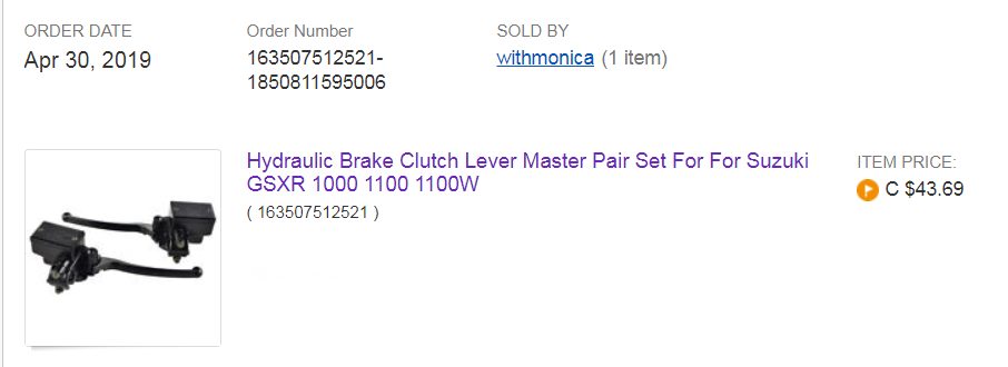

Regarding the "El Cheapo" master cylinders: When I converted to a Hydraulic clutch I purchased these as to have matching masters:
No issues or concerns. They work perfectly per application.

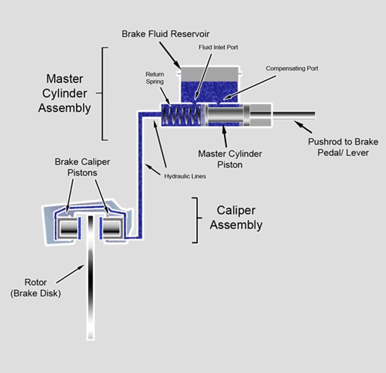

Minor point but your diagram has the equalizing/compensating port (smaller of the two ports) and fluid inlet port positions swapped (at least for modern motorcycles). And slave cylinder piston seals (square ones anyway) absolutely help with retraction of the pistons. You can verify this when bleeding the brakes: apply the brakes, when the bleed valve is opened, the pistons will retract slightly even though the master cylinder piston has not moved from it's fully 'engaged' position

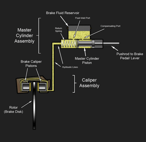

Not my diagram ! Copied from the net. as with the Following:
I guess they're all wrong.
Not going to debate whether the "seals and boots" retract the pistons. For the purpose of clarity - The spring in the M/C returns the M/C piston - thereby pulling the caliper pistons away from the disc. when the lever application pressure is nil. Fluid Dynamics !
