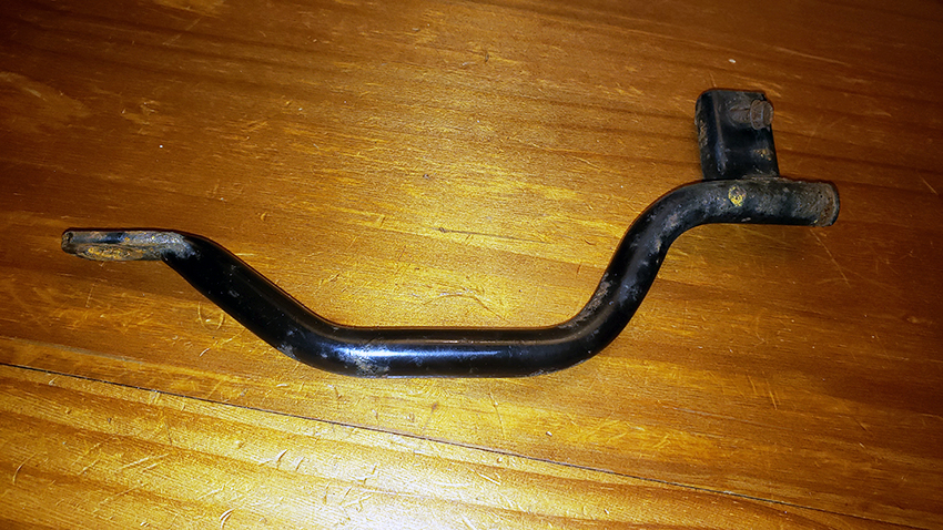

There is also the 'B' option. This seems to offer a better grip, but I like my aluminum better. It was black, so I had to polish it. This one would need some chrome if on my bike. It's also straight forward to fabricate.

7 years 5 months ago
Still has to be bent $$ and welded $$
0h, for sure, unless you have a workshop. If I had a place, welding machine would be the first thing to buy. So much can be accomplish with it, even if cutting and drilling has to be by hand!
I got this one off Ebay. I think US $15, just needs cleaning. I think this is the cheapest option. Not always available, haha, but they show from time to time. There is one perfectly painted on Ebay now, if you want to spend $45 and shipping.
Good stuff! I just thought this pipe type is good to throw into the pool of possible designs, and it's stock as well. It's quite straight forward. I'd probably forget about the welded bracket, flatten the right end, and drill a hole. Sort of like the stock aluminum I just mounted. Wold be cool to see one made from aluminum, as you laid it out. Any plans for making one?
