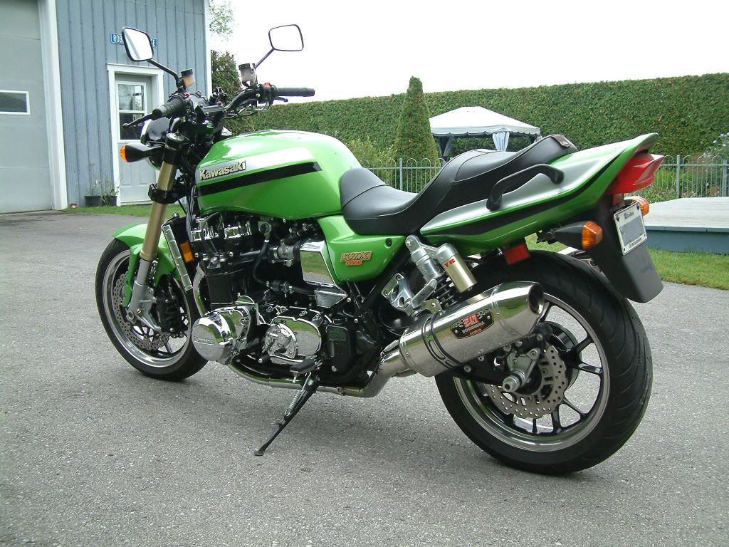

Then there's Robert Bolduc's ZRX1200R with a KZ1300 transplant. Drop dead georgeous !!
That is so good looking

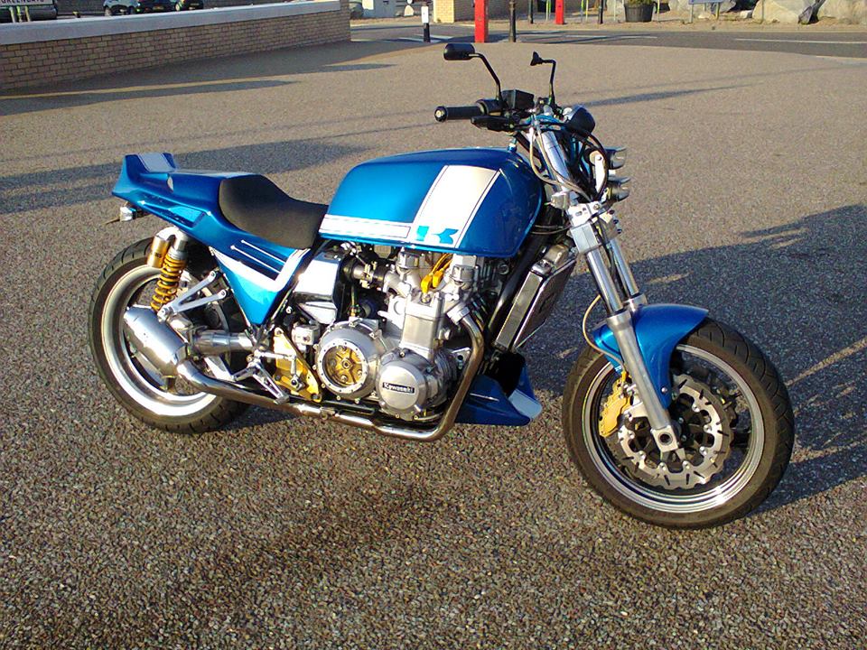

- Phil
- 1984 ZG1300-A1 DFI
- Posts: 460
- Thanks: 139
Re: Different front end ?
That Canadian KZX 1300 is perfection in my book
I fitted a ZZR 1100 (ZX-11) front end about 20 years ago. The forks had to be extended by about six inches using sleeves clamped at both ends & I had a one-off billet ally bottom yoke made. The steering stem slotted straight in from memory. The original ZZR 1100 4-pot calipers were more than adequate in hauling the 13's 300kg up, but I later went the whole hog & fitted some bespoke Pretech 6-pots.
