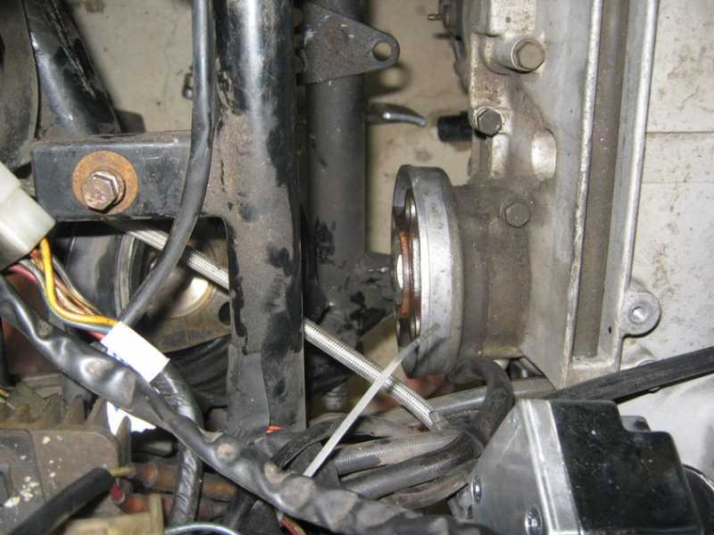

Hey guys it's me again with yet another question,
I am about to remove the drive shaft so I can remove the engine from the frame, has anyone got any tips on the best way to do this. I remember seeing an article on the old KZ1300 site which covered this but I don't seem to be able to find it anymore. I have undone the gaiter clamps around the drive shaft/engine coupling, the gaiter is split so I think I will just cut this off to make it easier to get at the bolts and replace it when I put it back together. Are there any traps that one should be aware of when taking this apart. Also are there any traps with respect to removing the swing arm assembly. Again I have read up on it in the manual, but I would rather look silly now asking lots of questions rather than make a mistake and get it wrong, there is nothing quite like practical experience to point you in the right direction. Again thanks in advance

I did an engine removal a little while ago, all a new experience to me, I have a manual and don't have any of the "special" tools so I make do. I just put a large screwdriver thru the gaps in the uni joint to hold the shaft while I undid the bolts holding the shaft to the rear of the engine, then undid the 3 bolts holding the swing arm bearing cap on both sides and popped them out far enough so the whole swing arm drops off. hardest thing I had to do was put that rubber boot back on after and get those clamps tight to hold it, a lot of swearing and cursing but I did get it done, cheers.
biggest tip I can give you ..... TAKE heaps of photos, that way you can look at them and see what goes where, saved me a few times
