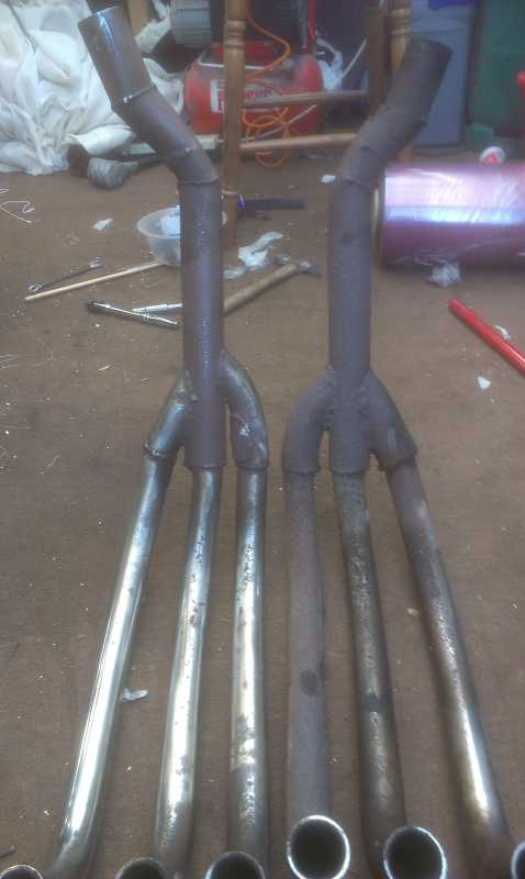

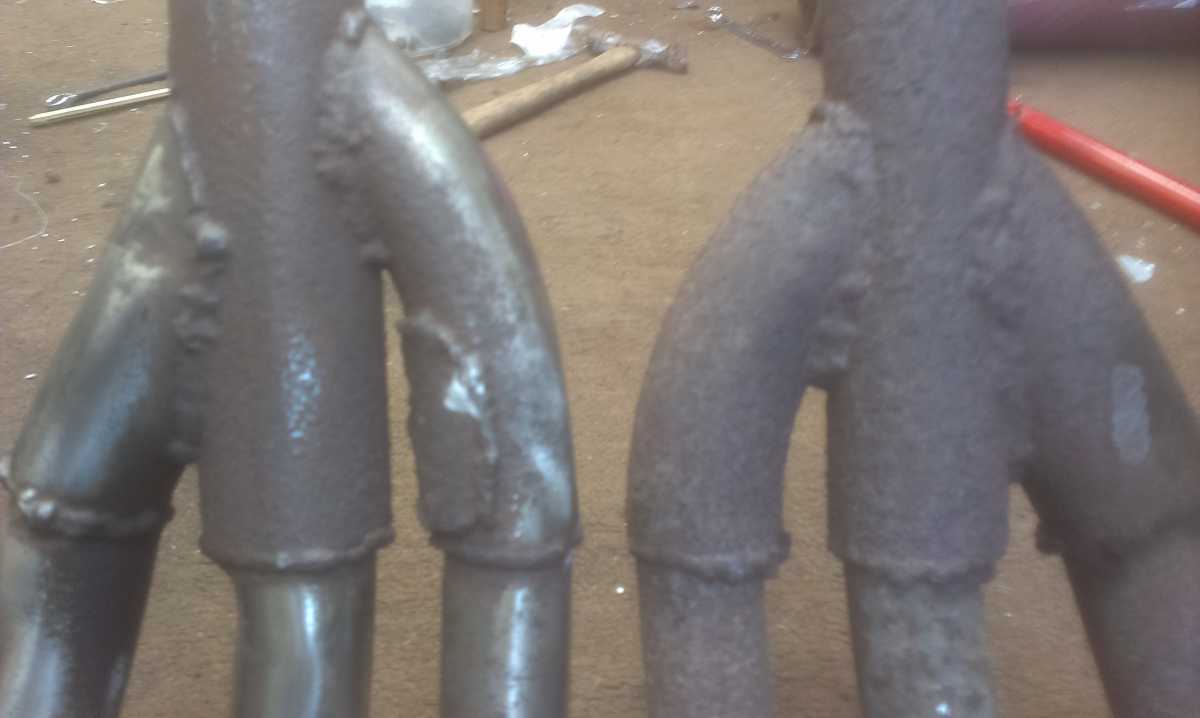

Hope I'm not posting too much at the moment but the plans are all coming together..This one is is looking for thumbs up or forget it! Got my stainless 6 into 2 to go on and have the bike looking pretty standard. The plan is to have a "loud" paintjob done on the spare colourset I've pieced together and I would like a 6 into 1 with the loudest scream possible as I am a big kid and like to show off.The exhaust that came on the bike is virtually unsellable as its been cut to bits and badly welded back together with bits of drainpipe and is covered in rust. It is however solid and strangely looked fine on the bike unless you looked closely. Does it seem feasable to get the two ends joined to 1 with a bit more drainpipe and try some different endpipes on until I get the sound I am looking for, and hopefully not looking like a complete arse...Just ignore me if you want...the Mrs always does when I start waffling!

Don't see why not, looking at the first photo all it would take would be to cut the left hand pipe pipe after the collector & join it to the right hand pipe after it's collector, which was pretty much the set up when I had my 6 into 1. BTW it's gonna be LOUD without any kind of silencer, but I think you know that lol.
