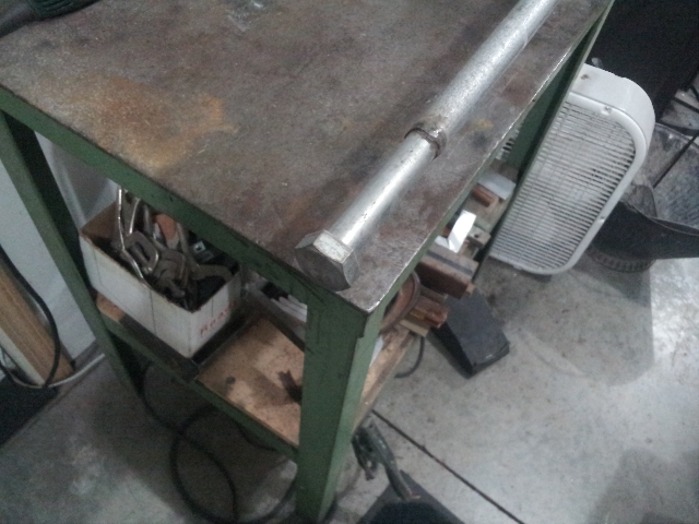

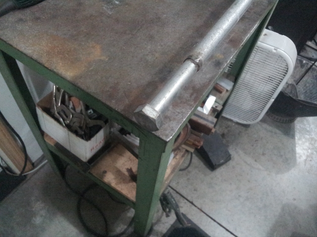

I welded two 5/8" bolts into a piece of EMT that's 42" long. The heads of the bolts are 7/8" hexes. It worked great.

KZQ wrote: Hi Lucien,
