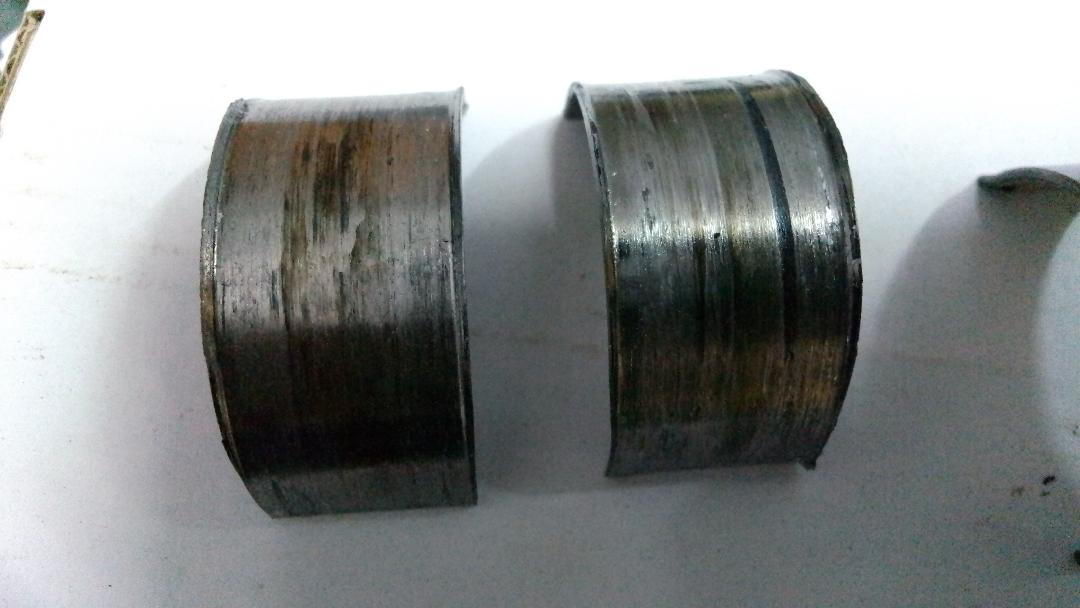

I had to replace the bearings on connecting rod number 5 since it had been repaired by Mackgiver using an empty can to make what I found when disassembling the engine.
Last December I bought a new set at MCG PARTS, I remember they only had one color, brown I think.
As far as the crank bolts are concerned, I didn't change them, I don't see the need to do so.
