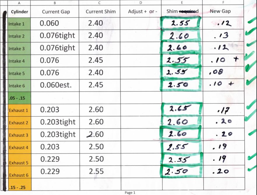

The required shims arrived last week.

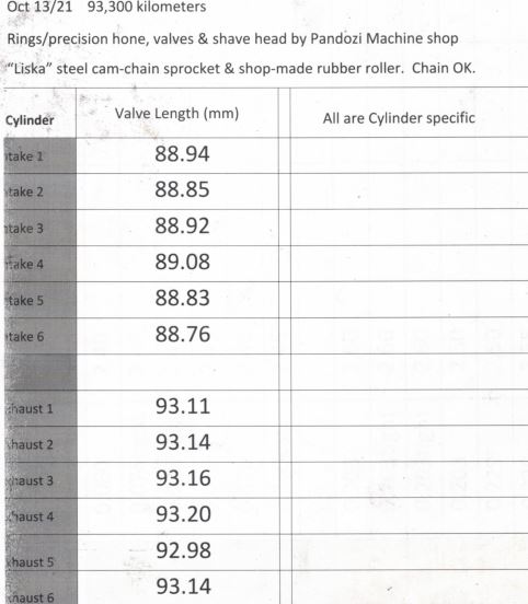

Whomever did the valve seats for you was kind. You still have lots of shim options for the future. Nice !!  Not like the disaster that I got handed back and now in the middle of replacing seats because they cut them too deep.

I'm very pleased with the machine shop work and the specific attention paid to the clearance concerns.
