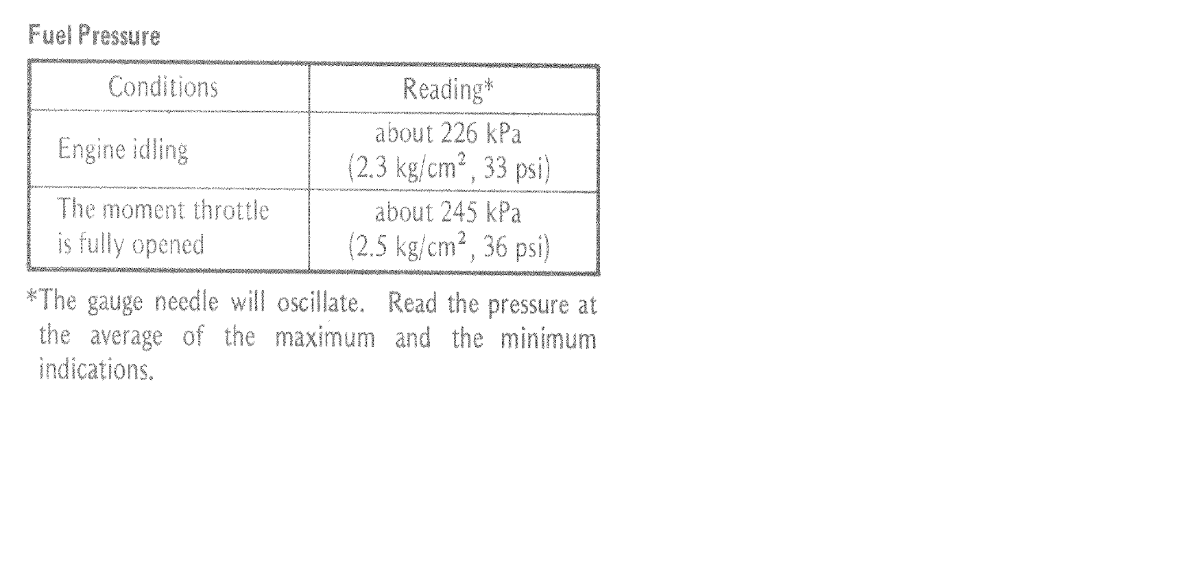

Can someone please tell me what is the proper fuel pressure for my 83 Voyager? I bought this bike and found it had no fuel pump or regulator. I would love to hear it run the way it should and be able to ride this monstrosity of a bike.

Straight from the manual section 3 page 23. (The manual is available from the Home page for downloading)
