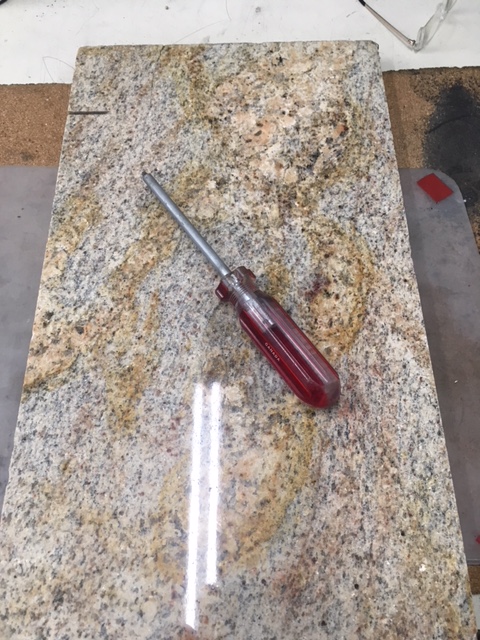

Go to a Counter-Top/Cabinet manufacturer. They'll have a bin of cuttings from Granite tops. The surface is ground and polished. They'll probably give you the piece.
I have used mine for cleaning and dressing cam-cover, side-cases, carb. tops and bowls. I just taped down some W/D abrasive, keep it wet with some water and go at it !
