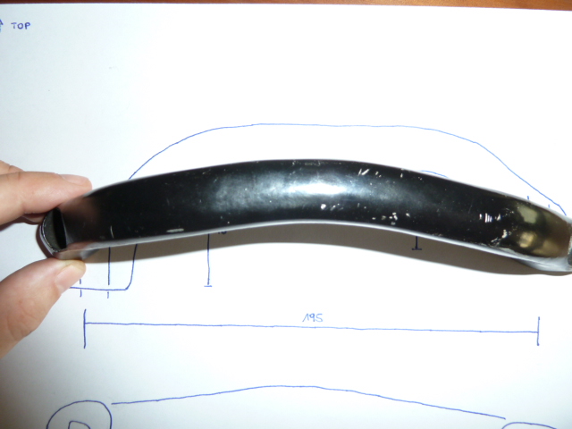

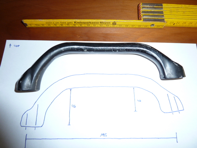

    would it help if you have a sketch with the original measurements ?

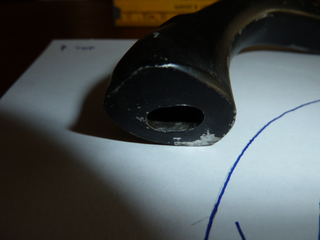

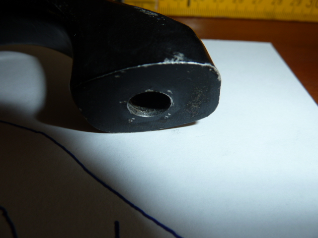

Does that handle have a circular profile, or is it oblong (more of an oval)?

    it is made out of full-material, probably cast or so. I'll see that I can make a proper sketch.
cheers
      cheers
- Posts: 804
- Thanks: 243
Re: Grab Handle?
    Does this help (hey, I work in a office, not in a workshop) ?
All figures in mms.
cheers
      All figures in mms.
cheers

    WELL now.... That might be very possible.... Thanks for the pics!
If I can find metal stock in that profile (or close to it), it looks like a few real simple bends. I can probably just weld a few sleeves on the end and fill in the rest with more weld. Grind it down to shape, paint/powdercoat, and there you go. Nice.
