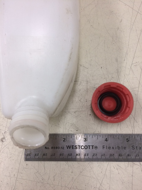

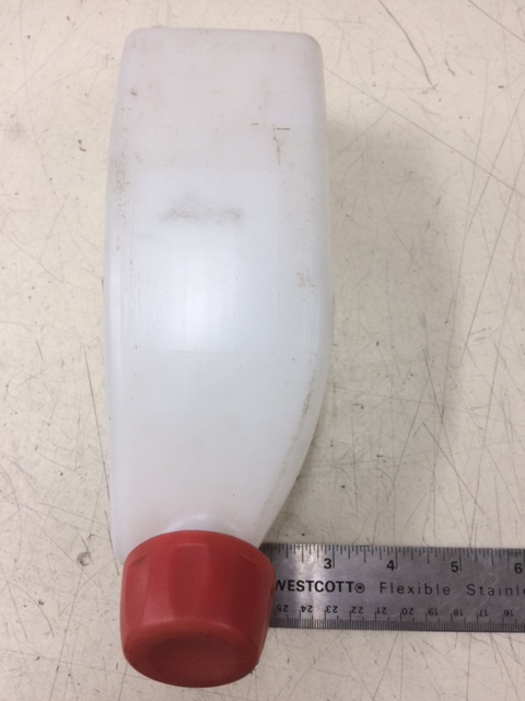

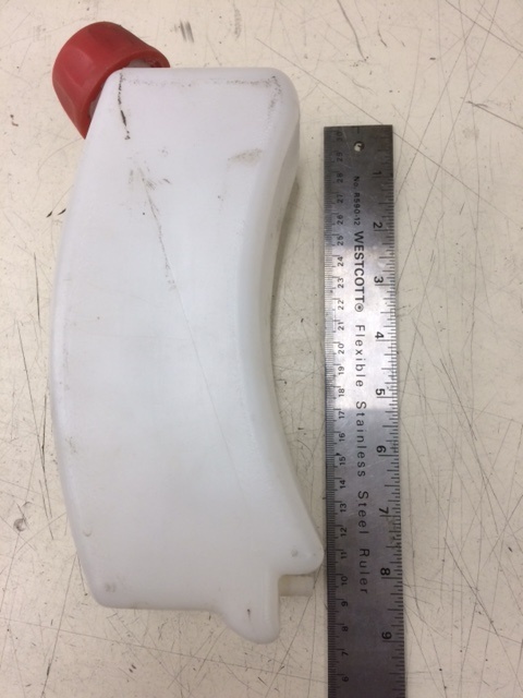

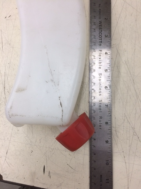

I've spent many hours "Google" ing" for a substitute. It continues to elude! The closest I can get is this: A soap dispenser from a Pressure Washer. Won't accept the OEM cover and has no securing points. The port is substantially smaller but could be drilled out a another size or two.

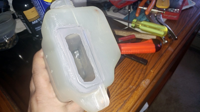

What I did with my original when it started falling to pieces was wrap it all (Less the filler-neck) with 2 layers of 6 0z. Fiber-Glass cloth and resin. The cover didn't fit so made another from a piece of fine metal expanded-mesh. Didn't look too bad, either! Ran that for several years without problems until I found a replacement - cheap ! It's now showing signs of age deterioration. There's several "Plastic" moulding manufacturers in my area that could easily produce these over-flow tanks but the problem is the tooling and set-up costs !!!! Same as CNC'ing a Prototype Cleaning Tool or a Spin-on Oil filter/Cooler ! It's "freakin" costly ! Then there's always a "minimum order" which is also a huge expense.
