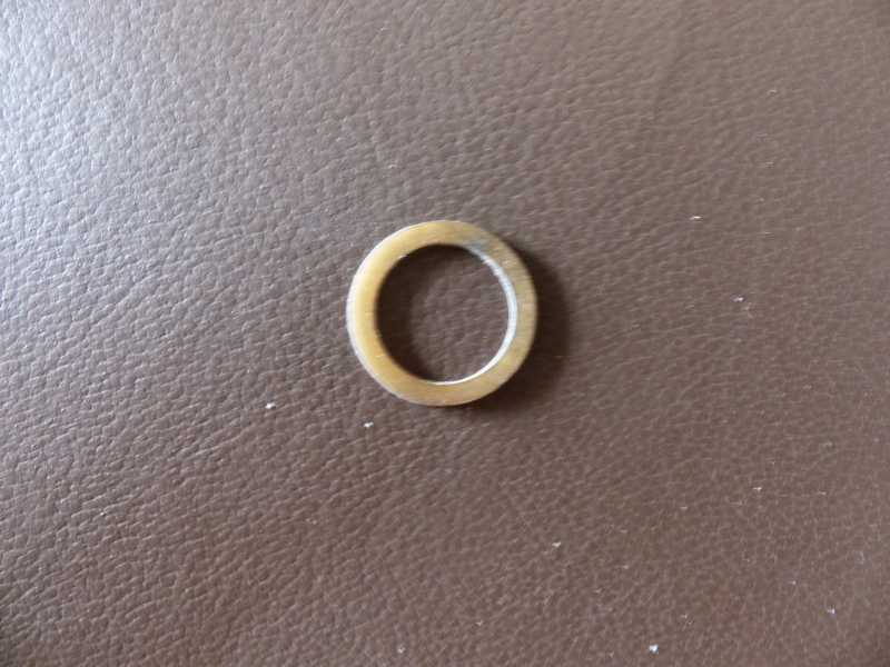

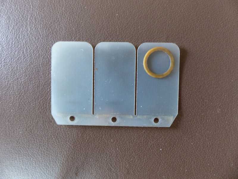

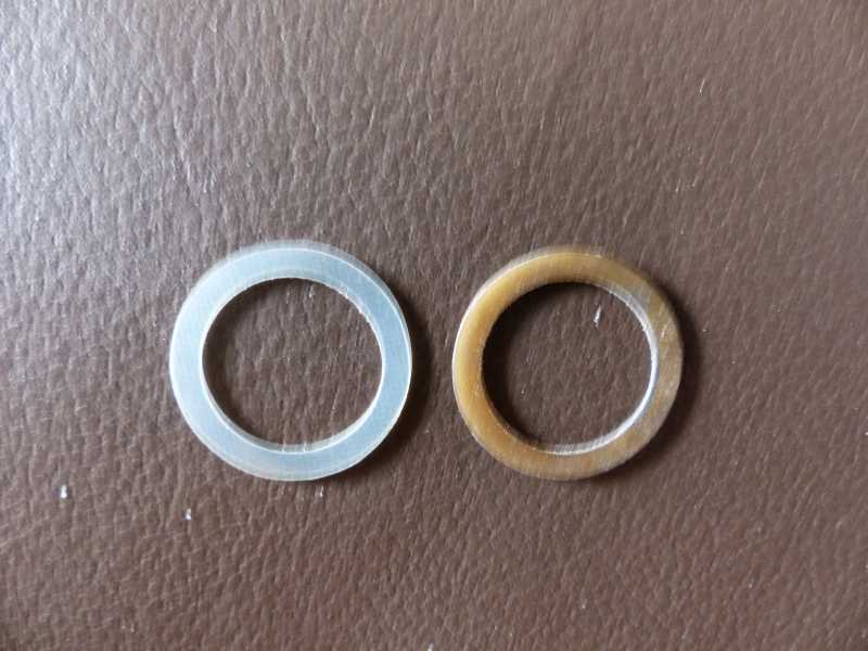

There you go 54 minutes. Done.
First pic old washer on top of new
Shazzam!!! Side by each.
now if you're interested in trying this, I drilled out a small hole through the reed first (around a 3/16" hole) then mounted a tapered burr in the end of my Dewalt cordless drill and spin it at about 60 rpm and massaged the reed over the end of the tapered burr and kept checking till I got to .512", then held the old fiber washer over top of the new washer and filed to O.D. down till I got really close, then hand filed the remainder and kept checking the width of the washer with my vernier until the width was at 2mm (difference between the id and the od.)
Necessity is the mother of invention. Hmmm Yammy reed in a Kaw carb, it's a Yammykaw now.
