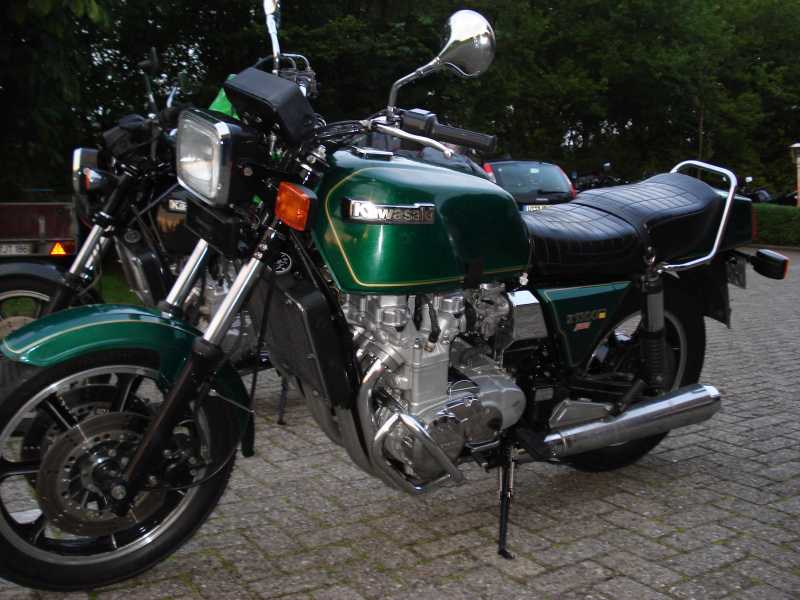

guess it's too late, hope it helps anyhow:
Foto taken myself years ago as it was the frist time I saw the original Luminous Holly Green
regards
regards
