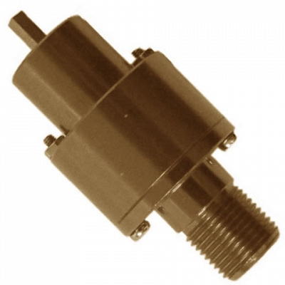

The front wheel drives are the same. The "guts" for a MPH and a KPH look identical but they are not.  The gearing in the head itself is different, which allows for the various face plate increments.  I discovered this when I had to cannibalize 2 instrument clusters to create a new cluster on a recent '79 "Barn-Find" restoration.
You would have to install a mechanical converter on the front wheel-drive

Another option would be to replace the speedo drive gearbox with a kilometer based gearbox. I see several gearboxes on EBay and one of them is located in Canada. It would be worth an inquiry to see if it came off a bike with a kilometer speedo head. My 1980 B2 is a Canadian bike with a speedo clocked in Kph with a 240 Kph max on the clock. I'm sure there are a few different drives out there because some of the bikes had 160 Mph gauges and some had 85 Mph gauges, Maybe have a read through this search   Using the search tab for "speedometers"
