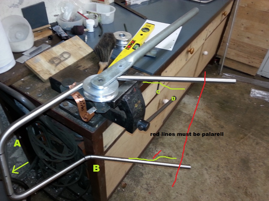

Stan, you want to do it you self ? If yes Great!! Yea the type of the bender i used is in my opinion best for the job because you can "maneuver" around it with the pipe, and is cheap to. Making the bar: important is that you start from cutting pipe to desired length and making mark at the the center of it (arrow) Next you need to make a sample bend (some 25 cm in the length with bend starting at for example 10 cm from one end than the bend, that's important because you are going to make final measurements off of it, so no random stuff there ) ideally out of the same type of the pipe you using to build the bar or just take thick wire and make two bends with radius of the dice on you bender in two angles (A and
. While the long pipe is still straight you must make all the length markings (apart of C and D) from where you start to bend and while bending draw the lines on the dice for the angles so they will be the same left and right. For the difficult part now, that's where simple bender pays of, the two final bends (C, D) towards the end of the pipe where the bar will be fixed to the frame, you have to go by the eye to mark the beginning and to spot the right angle (against the marked red line, imagine straight ledge would be there) while bending the first in, and than the second out than the other side. After that just cutting to desired length, flatting it and making hole.
That's for the pipe. You still gonna need two brackets but that's for later. If You need measurement guidance ill measure and post here. Let me know how it goes, it would be Christmas present for you Kwaka. he he.
