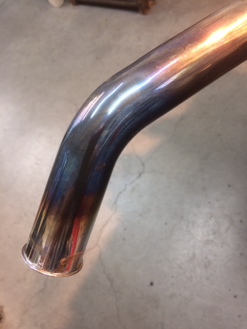

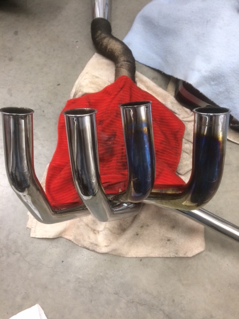

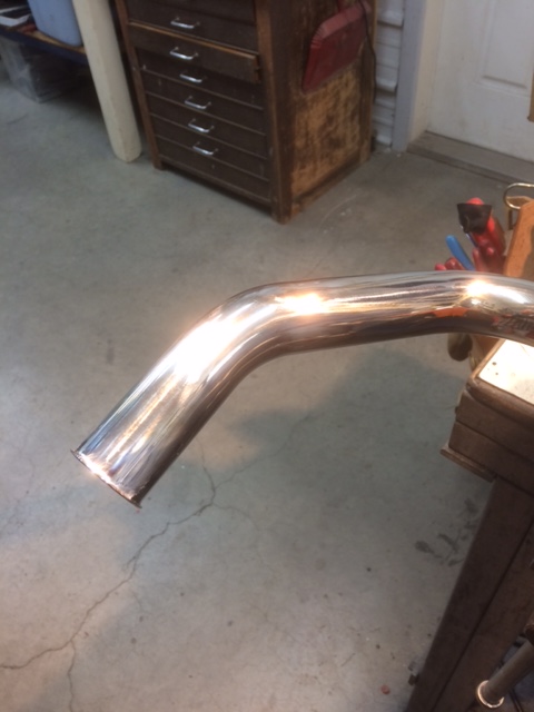

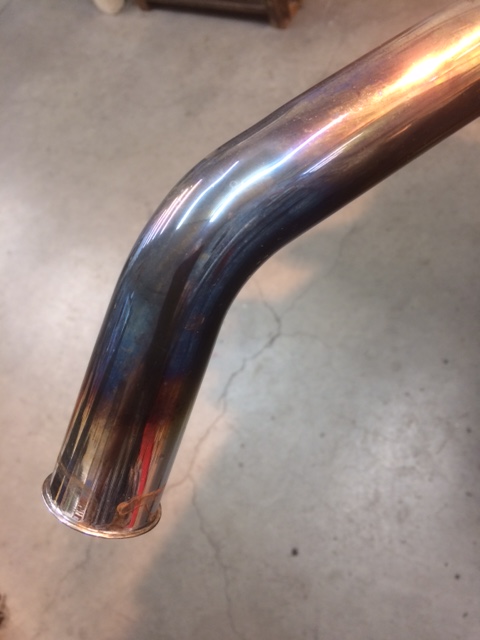

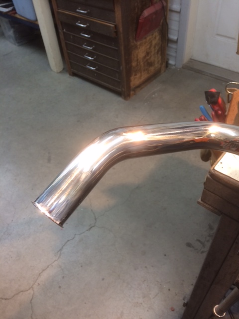

I tried hand polishing the headers but to no avail. However; some WHITE polishing compound on a buffing wheel did the trick. How long it will last has yet to be seen as I expect they'll "Blue" again but I did get the minor dullness out of them, lower down, created by years of being sand-blasted from the front wheel.
