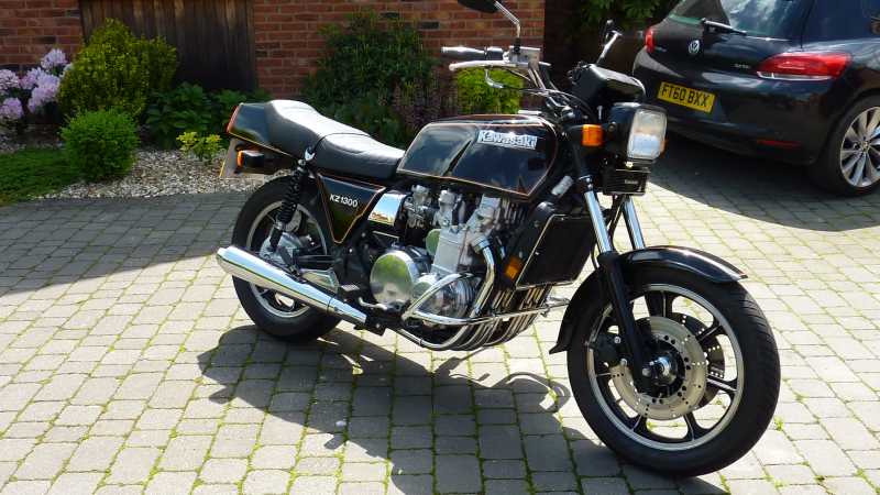

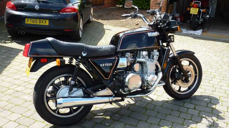

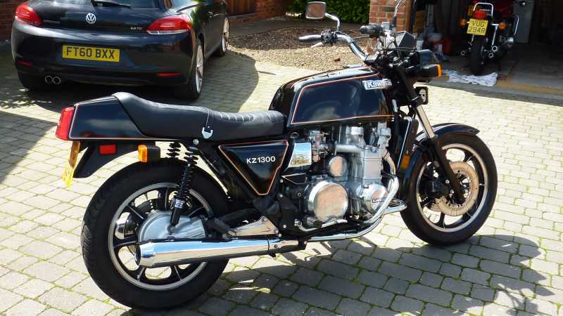

Guys, I have a dilema regarding a torque setting on my US Model 1979 A1.
Finally got my Z13 back to her former beauty, but have been through "death of a thousand cuts" sorting my dodgy starter clutch and sub rotor assy, and now have a fully functioning Z13 for the first time in 3 months :woohoo: :woohoo:

Your A-1 looks great!
