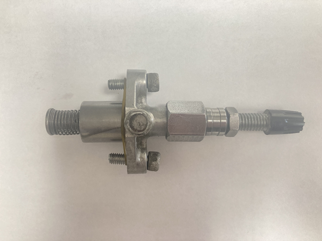

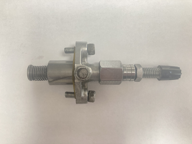

Have these on my bikes.....and they haven't blown-up !
Now on someone else's 1300....albeit 45minutes too late !

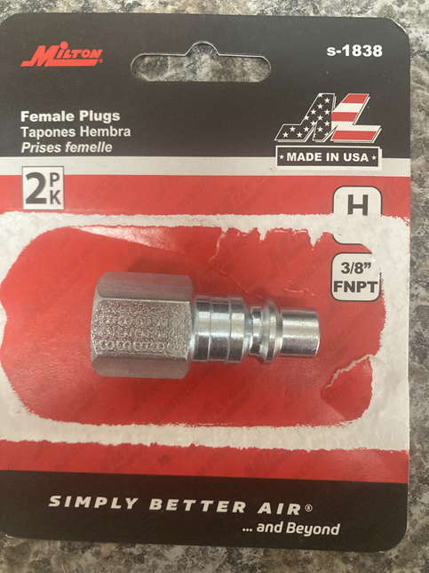

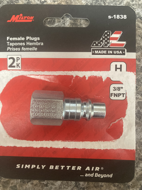

$6.00 per fitting plus an appropriate size nut and bolt ! The "style" of air fitting is irrelevant as it gets cut off.
Tap for a bolt of choice - otherwise, self explanatory.

I like the way this mod bolsters the casting of the tensioner and gives the backing rod a steel thread to work against. Much better than trying to fit a nut inside the tensioner casting.

Thanks. Simple as it gets. As it happens, the diameter of the Tensioner matches the internal thread dia. of the fitting. 6 to 8 rotations and the fitting "self-threads". After assembling my first on I removed the fitting to check the '"witness" marks on the Tensioner. It's not going to come off !!
