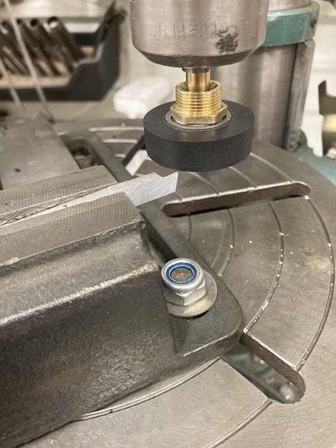

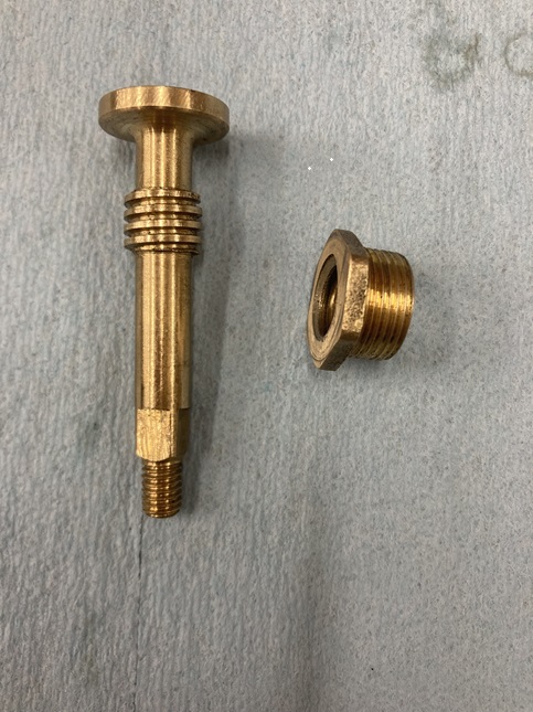

How to remove the "center rib"
I had a valve stem from a house hold shut-off
Requires very little material to be removed from the thread to get a perfect snug fit into the needle bearing.  Did this on the drill-press using a fine file.
The rest should be self explanatory
