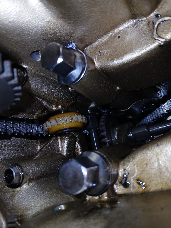

I was recently disappointed to find that my toothed roller shows quite a bit of wear. The engine has 22,000 miles on it. I just did a valve adjustment. Looks like I'll be looking for a head gasket soon.

You would have thought that this cam chain idler gear would last longer than 20,000 miles, wouldn't you?
