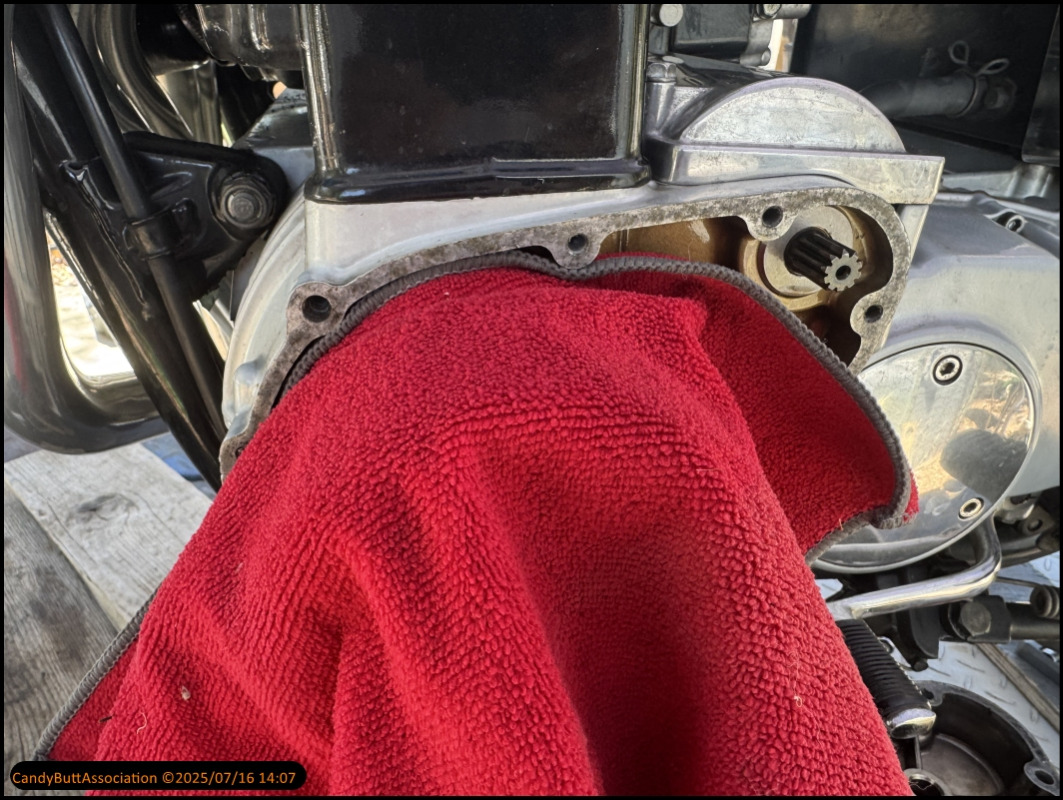

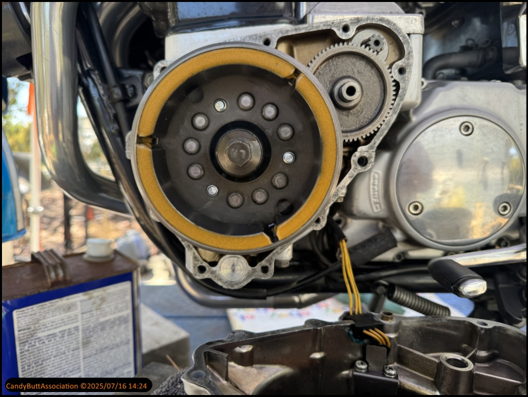

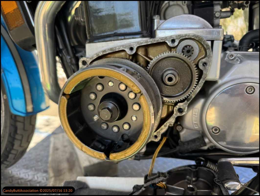

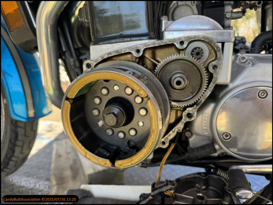

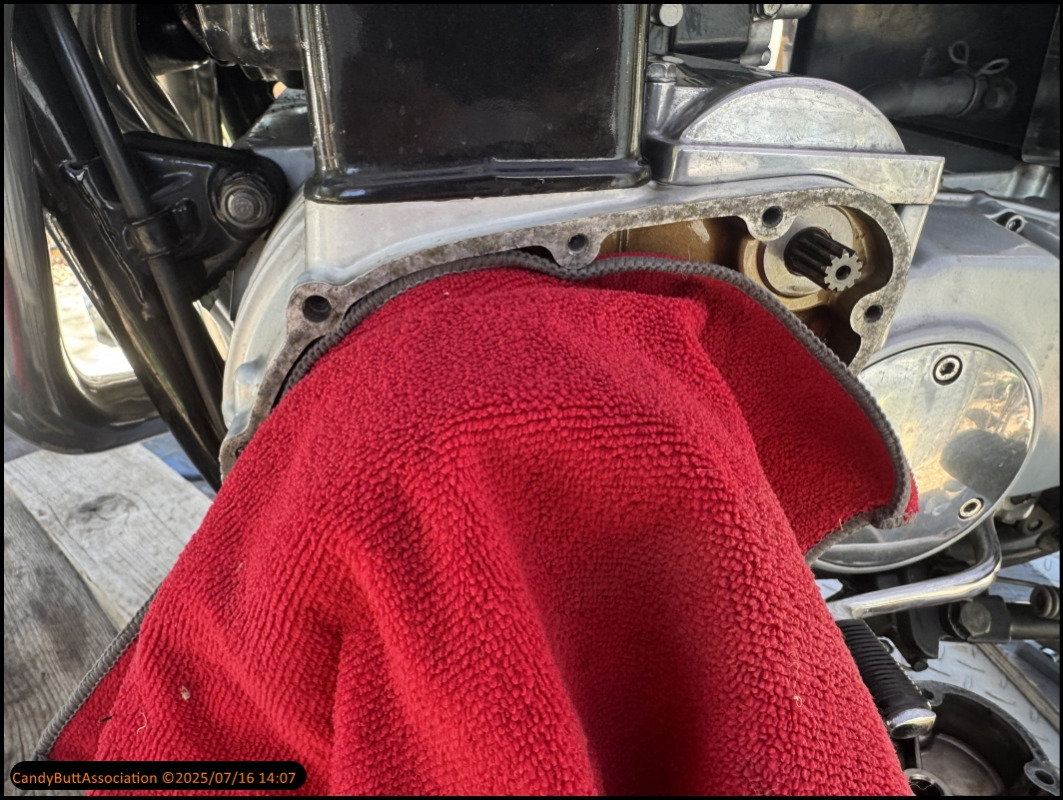

It happened again.
Grumbly sounds at idle. Thought it might be cam chain, so checked and no adjustment needed (APE tensioner).
Had rotor puller bolt thingie in tool box so ez pz.
Clean clean clean.
Can't use lock washers, would cause interference fit (rubbing).
Cleaned threads with brake cleaner, used LocTite Blue.
