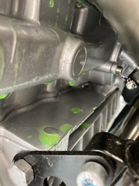

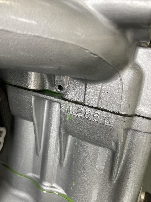

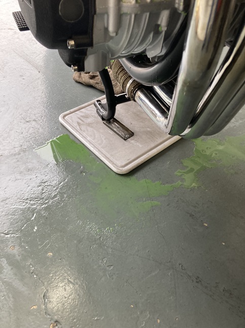

Expecting to simply add add oil, coolant, brake fluid and START; I ended up with another gut punch. As soon as the coolant got up to the head.....the fucking thing started puking my new coolant !!
And before someone says, " Your head must be warped".......IT'S NOT. My trusted machine shop found the head to be within less than .001" and the cyl and head surfaces clean, and of no concern.

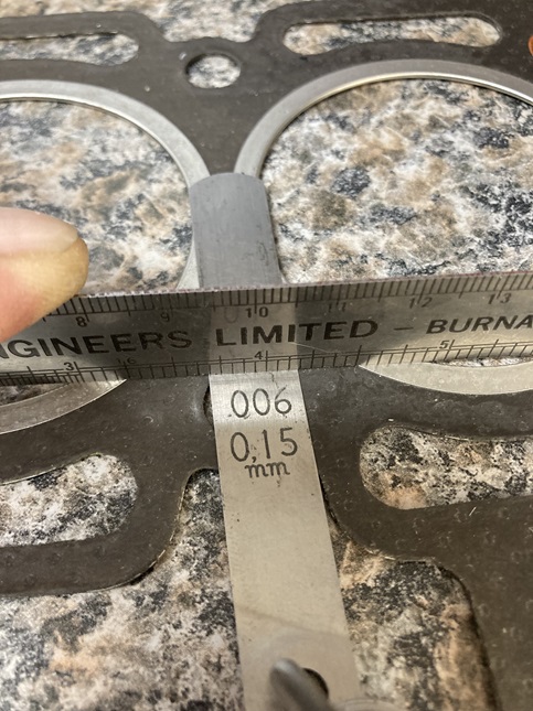

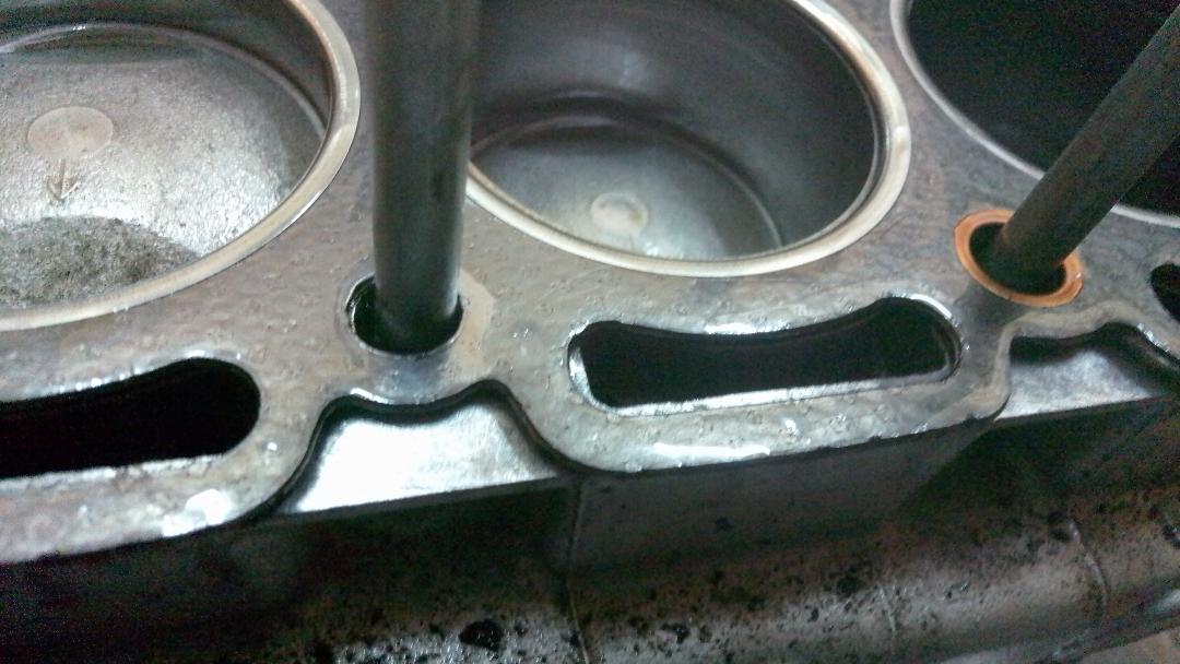

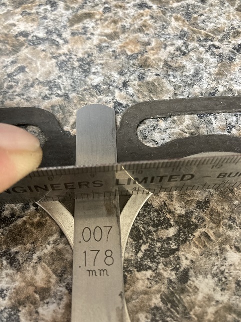

What I discovered when this piece-o-crap was removed was the fire-rings didn't compress flush with the gasket material. Also note the lack of any "sealing" rings around the cooling ports !
Can no one make a #^%$# aftermarket H/G that actually *&^%$# works?

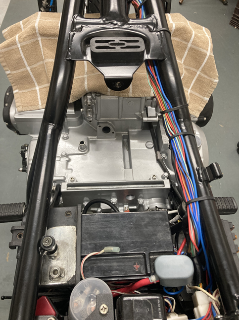

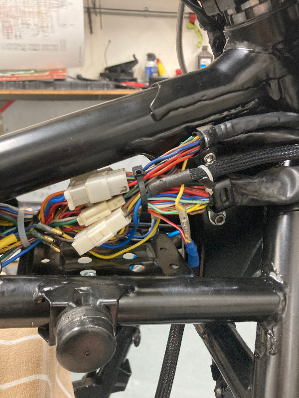

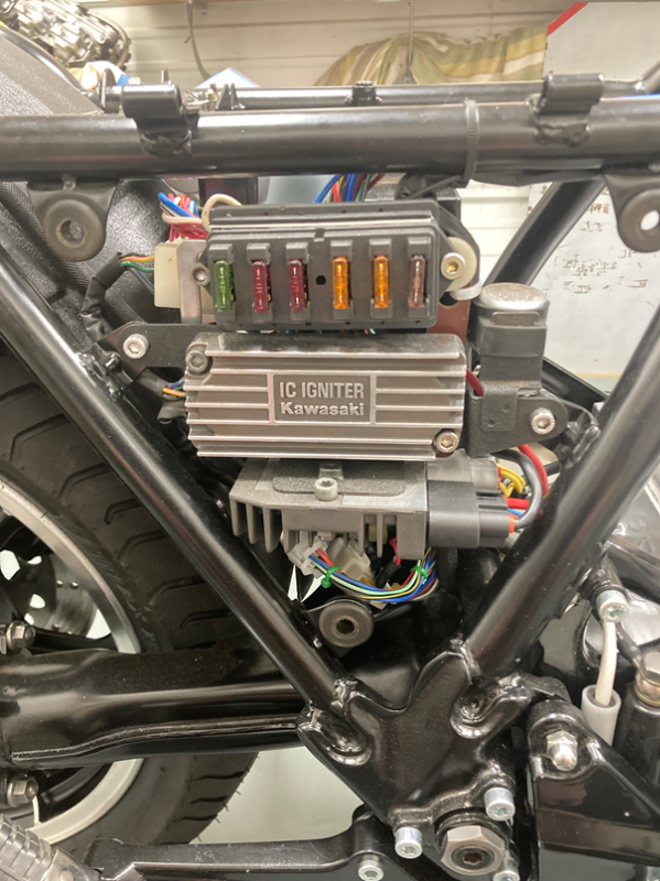

This past week I finished all the electrical - everything works, but it was a fair bit of work. Two-thirds of the plug ends and terminals were replaced. I stripped the sleeving and tape wrap to check all the wires and splices ...that you can't see and would never know they were there and did a lot of untwisting and reorienting. I decided to leave the harness bare.
Note to self: " Straiten the fuse bloc" !

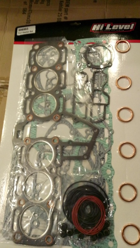

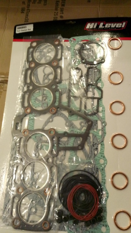

A couple of years ago I bought a complete set of engine gaskets with the suggestive name “HI LEVEL” from a dealer in England.
I paid half the price of the original ones.
In the case of the head gasket what I did was to smear it in oil a day before fitting it.
What's more, a week after the cylinder head was tightened with its torque I had to disassemble it again as I had forgotten to fit the timing chain guide.
I reassembled the engine with the same gasket and had no leakage.
The engine ran for about 4 hours in total reaching several times its working temperature until I disassembled it again, the gasket came out intact.
