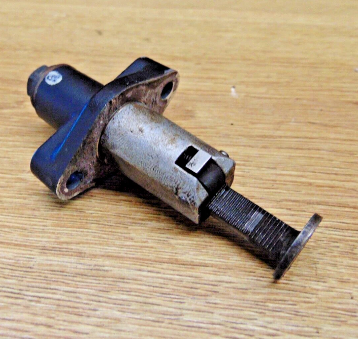

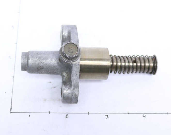

I am aware of the issues with wearing that the original tensioners can have . One of the first things I did with the bike was check and see if the tensioner was changed for one of the ratchet style one and it was.
I will have buy an oil pressure gauge and check the pressure.
I will also need to find my endoscope camera and dohet a better look inside.
The pictures are reference so you know what type of tensioner I'm speaking of.
I will keep you all updated as I go. This bike is one of a couple projects I have going on, so It may be slow updates.
Thank you for the information. It all helps.
Original style
Current style installed

You're working with a ZX11 tensioner which is one of the tried and tested mods done on the KZ's.
Some have found the spring tension on the ZX11 tensioner to be much higher than the KZ tensioner. A few have cut 10mm off of the spring to lower the tension. I have no experience with this tensioner or mod and maybe another member with ZX11 tensioner experience can chime in here please. I have wondered if cutting the spring had ill effect when at maximum stroke.
Be aware that the nylon sprockets can and have worn down keeping the original appearance yet the minor diameter of the sprocket was found to be greatly reduced. Usually we find the teeth all chewed off. Somewhere on the site I posted pics of a used but within tolerance nylon sprocket beside a new nylon sprocket and then there are other pics of the Liska sprocket.
the noise you describe has been heard many times before and reported. Some paying attention caught it in time. Some paid the price and jumped cam timing which then bent valves. Here's hoping that you've caught it in time.
