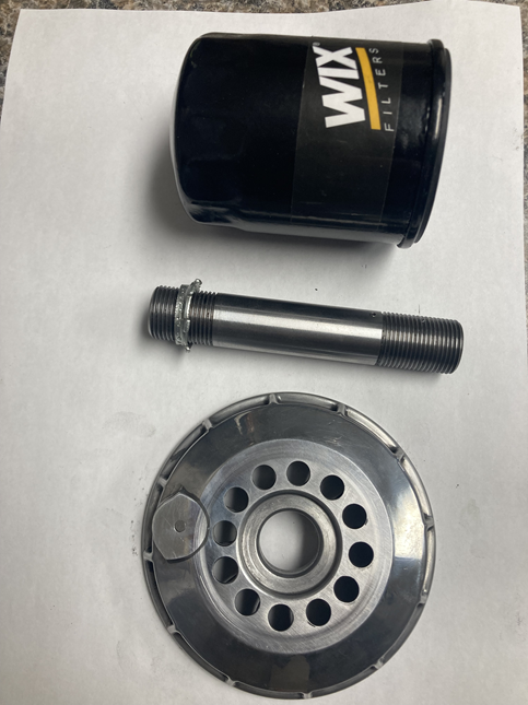

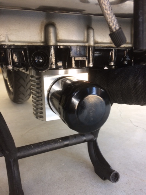

From my first oil/filter change 45 years ago I despised the damned F'n messy cartridge !
My "Oil-Cooler Spin-on Adapter" dealt with that annoyance. No mess ! Only a single drop of oil on the bottom edge !

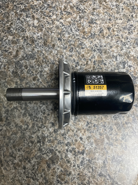

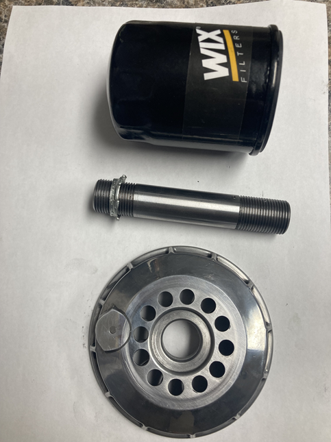

Along the same idea I have done this. Not as neat but neater then the cartridge and the filter is $11.50.

Less complicated than version 1 so more cost effective. The mess that is created spinning off the filter gets tossed with the old filter, so that's good too and I'm guessing adds 1/2 liter to the oil capacity? . Nice .
