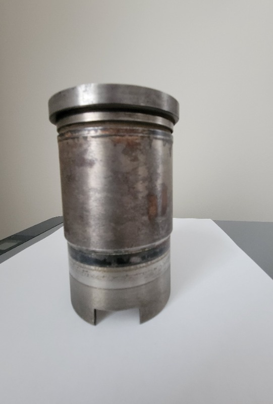

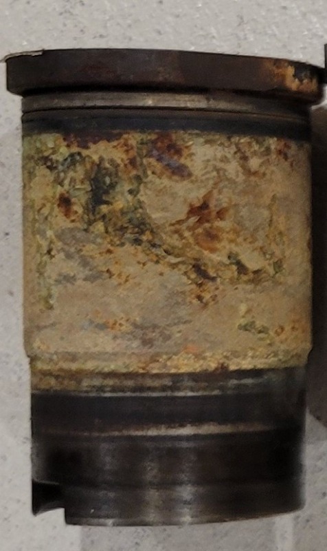

Last summer I pulled the sleeves out of my cylinder block and this is what I found. Pretty ugly. I restored the sleeves and reinserted back in to the block, but I don't want to see this corrosion again.

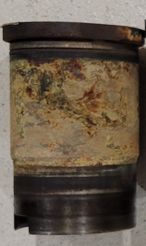

This was 1 of 6 all the same.

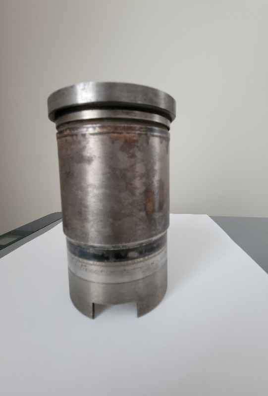

This what they looked like after cleaning up with a smooth file on a lathe.

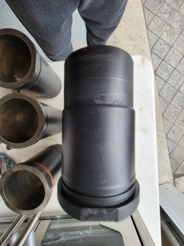

And finally, after applying Ceracote
