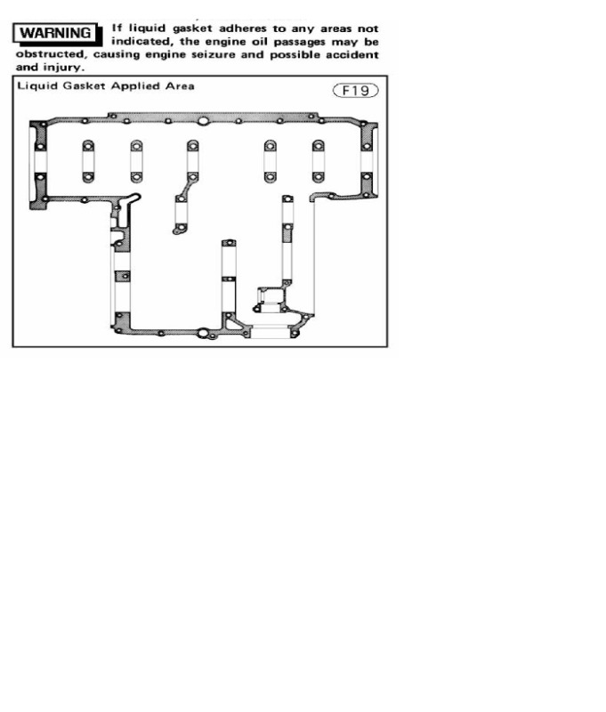

You also asked where to apply the sealer. As per page 101 of the Service Manual drawing F19.
