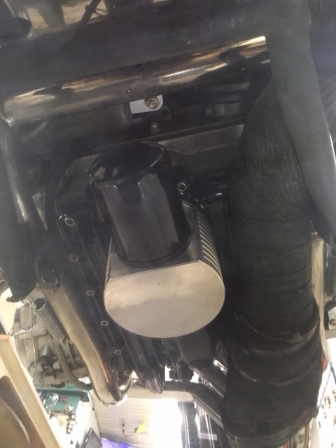

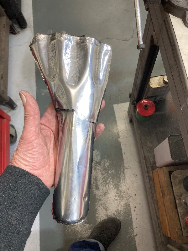

For what it's worth;

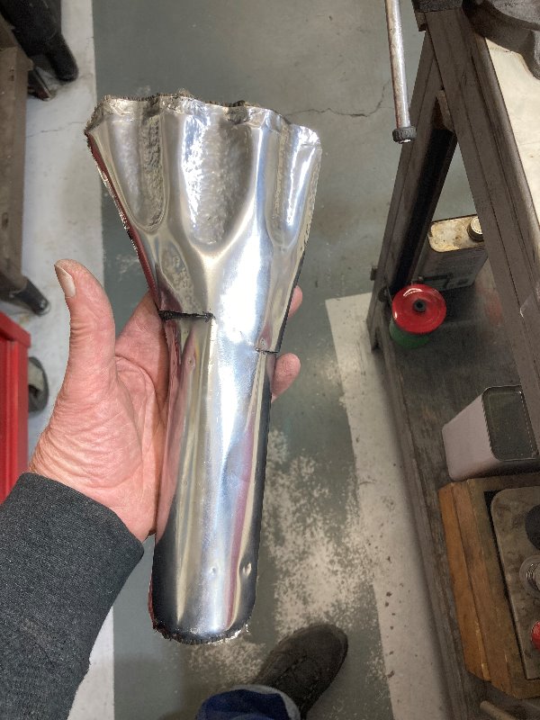

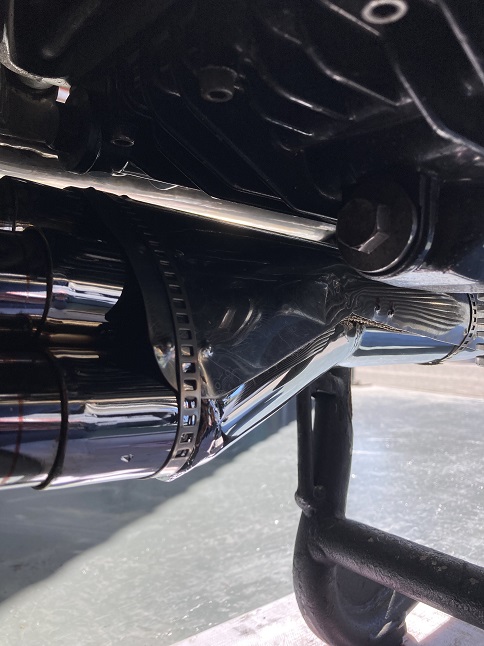

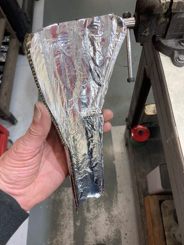

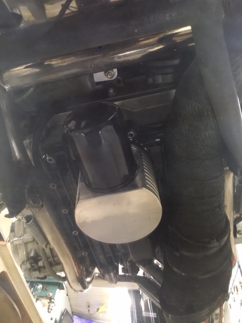

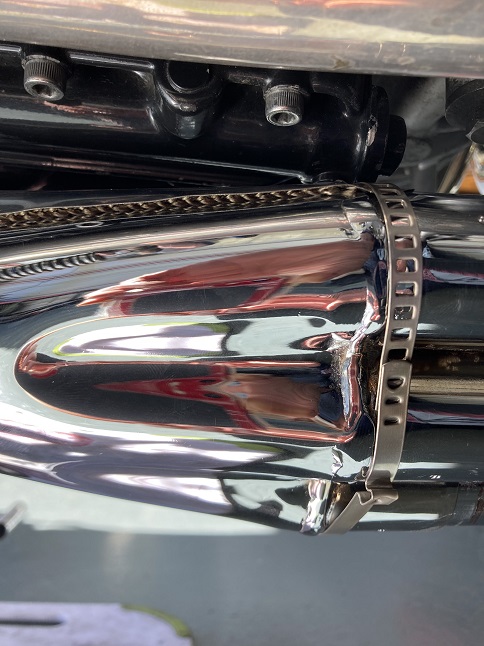

A few years(?) back while reinstalling the oil pan ( oil screen service) I had reason to think about the significant heat transfer from the massive header collector, to the oil pan. I decided to wrap the collector. 34' of header-wrap (one piece) provided a double layer of insulation. It was so effective that I could touch the wrap without burning my hand. While recently dealing with the D.G. bullshit I was considering doing the same with the new collector but thought it would be criminal to hide all that new shiny chrome. My solution for the new exhaust was a S/S shield. It has 2 layers of header-wrap with a layer of aluminum foil and is retained by 2 C/V boot clamps.
It's discreet and equally affective in preventing the Collector from "cooking" the oil-pan (oil) .
The oil temp. is kept under control in 2 ways. The "shield" and my oil cooler/spin-on adapter ( picture of my previous exhaust system with "wrap".)

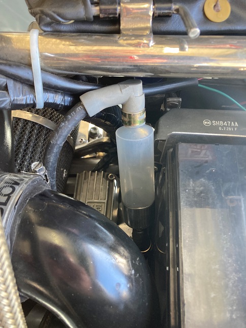

Riding the past two years in 38 C. / 100 F. air temps. the oil never went above 75c. / 167F. I had some initial concerns about moisture in the engine and the low oil temp. not being able to evaporate it. That was quickly dispelled and no longer of any concern. To confirm crankcase condensation is being dealt I installed a temporary accumulator between the crankcase vent and my air filter.
It will initially have condensation collect in it but that evaporates quickly once the engine is up to temp. I've never seen any condensation in the "sight-glass".
As I said at the beginning; " For what it's worth? "
