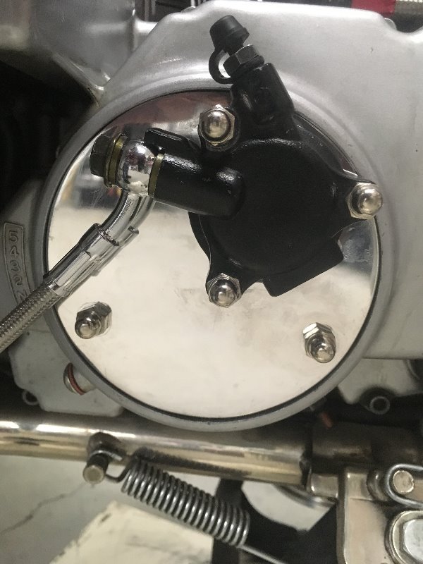

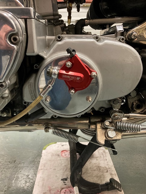

I did what some do when converting from cable to hydraulic.  I bought a used slave.
despite a new seal and some work involved in removing some bore scratches, it had an annoying, intermittent weep.
I Just replaced it with a new "Oberon".  I should have done this in the first place !

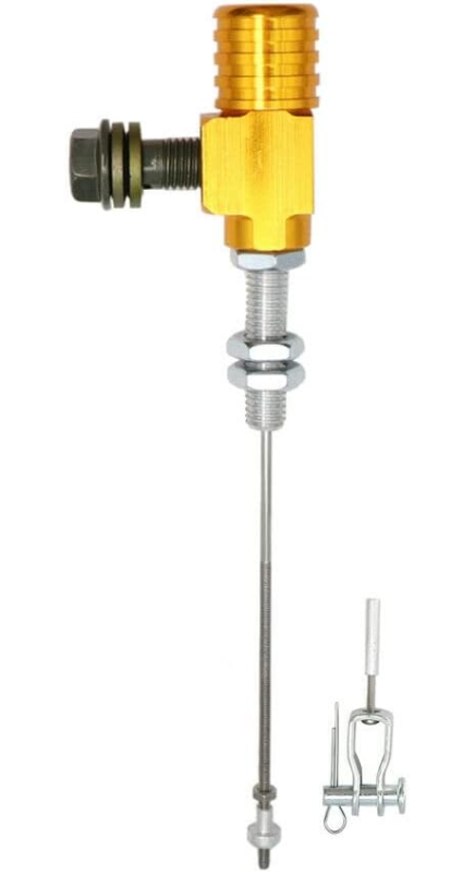

I can't remember .... somebody here tried using one of those hydraulic clutch cable end adaptors - was that you Scotch?

Do you have any spares/ who made the mounting plate -I’m looking for two ?
  • Posts: 2064
  • Thanks: 952
Re: Hydraulic Clutch Slave
2 years 6 months ago
I made my "plate" from 6mm aluminum.  No spares as I don't make them.

Not sure  what you mean by "clutch cable end adaptors ".
Pretty sure he's talking about one of these "alternative" clutch slave cylinders
