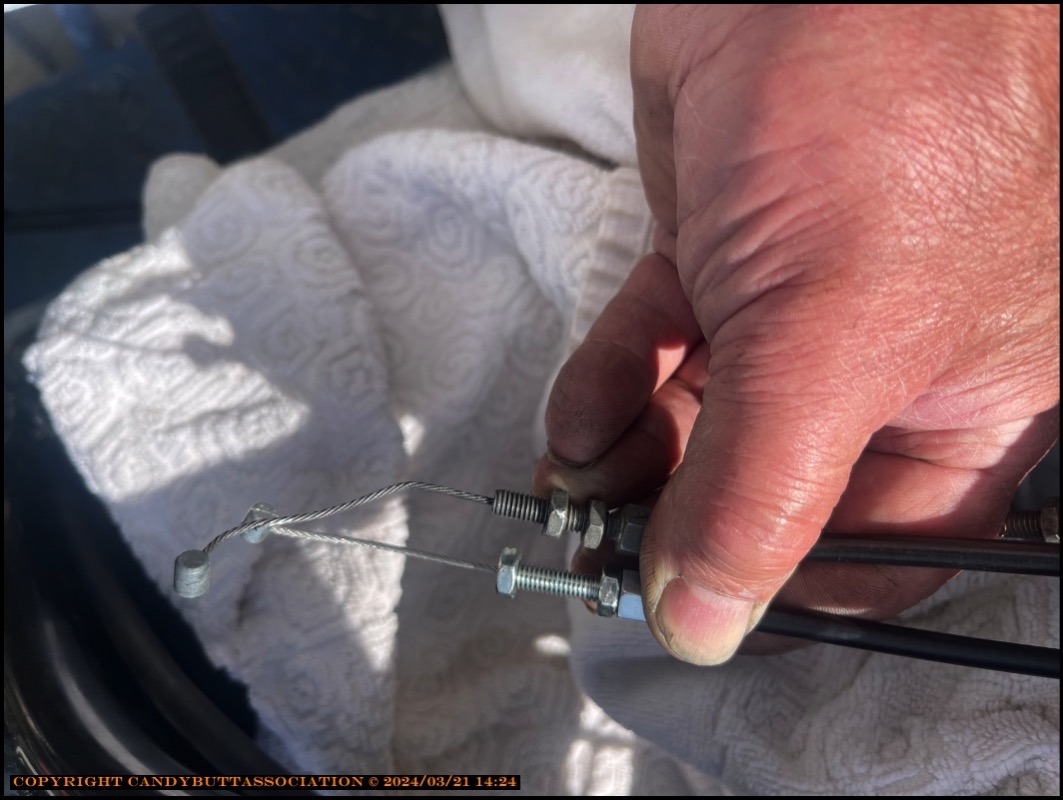

2 years 7 months ago - 2 years 7 months agoOEM - 72 mm - top cable
Zed Parts - 60 mm
Tried running cables with both nuts at thread end, but the geometry presented a noticeable stiction point right off idle when opening throttle. Sticky.

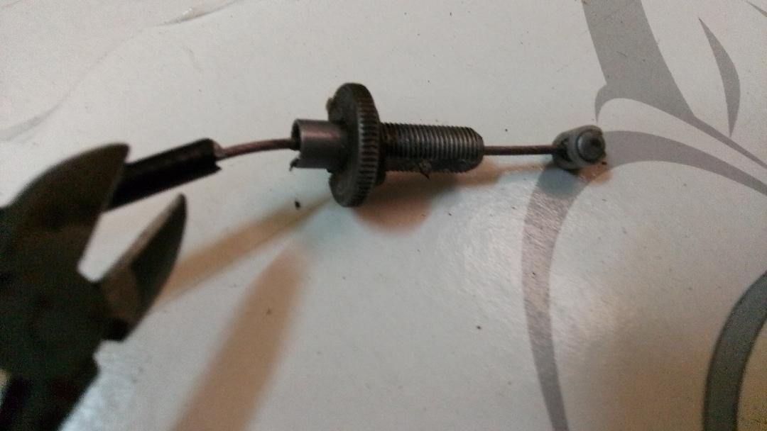

As I told you in the first post.
You must cut the cable sheath one centimeter.
Separate the cable sheath a few centimeters from the tensioner screw and cut it with pliers, being careful not to damage the cable.
You will have a wider fit tolerance.

Yes, that would work, Thank You.
But since the cables do have slack, I'd rather not attempt surgery when surgery may end up nicking the cable. And, the cable must be glued to the ferrule, as the two pieces don't want to easily separate.
