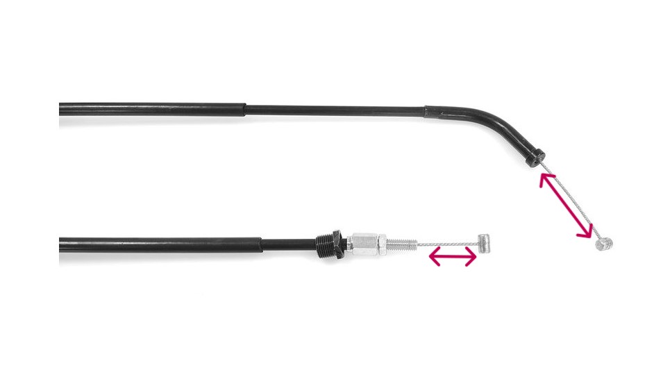

2 years 7 months agoThe problem is in the cable sheath.Are they the correct cables? The European market 1300 has narrower handlebars, and presumably, shorter cables
There is little distance from the end of the sheath to the head of the cable for the regulating nuts to operate.
The required length of cables with both ends provided with a head is measured with the cable sheath.
