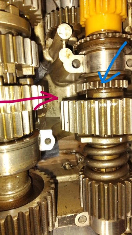

If it has gone to the rear of the secondary axis it may have fallen up on top of the block where the red arrow points.The blue arrow points to the sprocket that drives the timing chain from the secondary shaft.

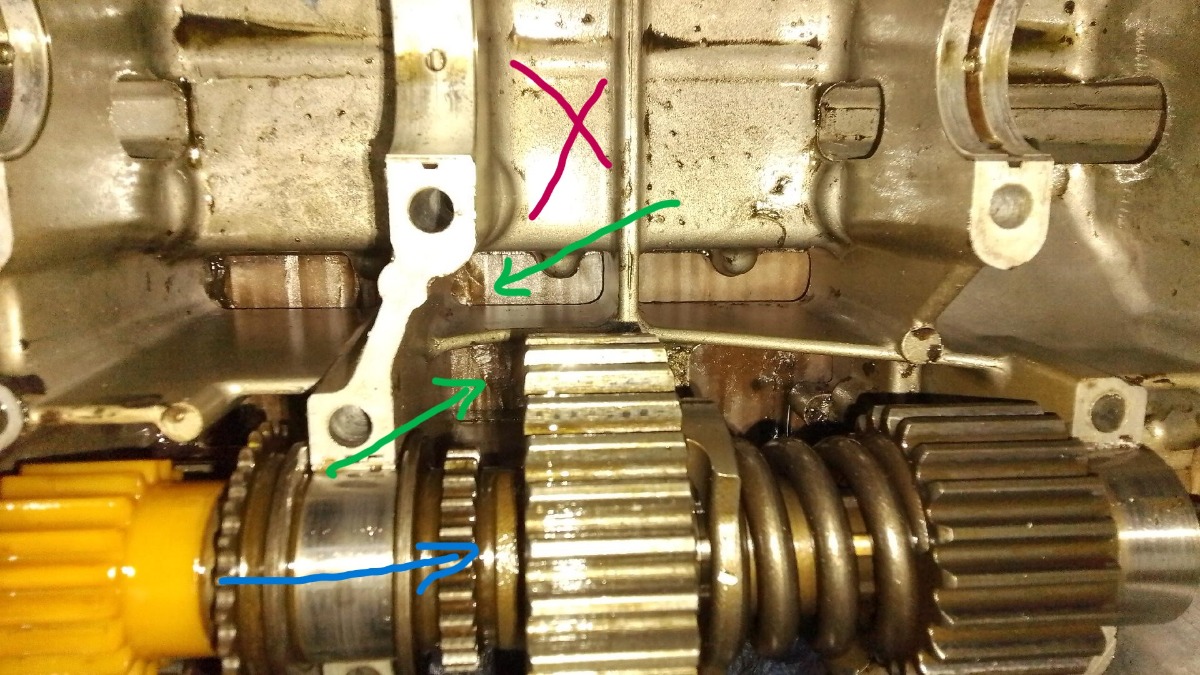

If it has fallen forward, unlikely, it may have passed through the openings towards the oil pan, green arrow.
Or under the crankshaft, red mark.
The only possible accommodation in the oil pan with direct drop from the top of the block is marked in red.
Dismantle the oil pan and try to access the possible places that I indicated with a magnet.

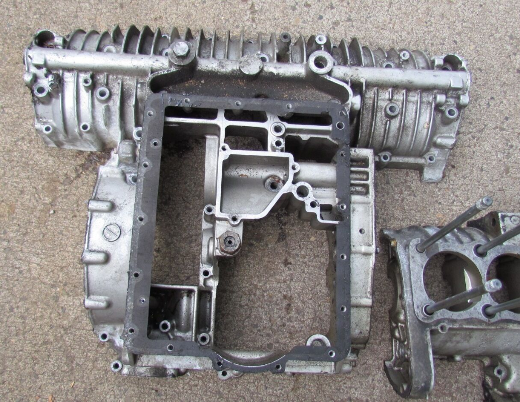

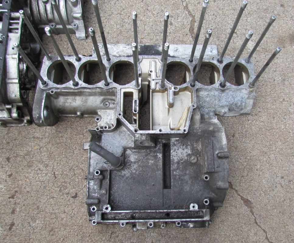

There are a number of possible areas that the bolt could have ended up, so first off, don't roll the engine over (turn the crankshaft) until you retrieve it and is it "just a bolt or is there a washer on it. I only ask so as to trigger you to think about that as well
Down in that "hole" there's a primary drive chain, a secondary drive chain, a ignition / water pump drive chain and a camshaft drive chain. There's also a small shelf that it may have landed on. Most likely, it fell through to the sump (oil pan)
I've attached a pic of the lower crankcase pictured up side down. Hope this helps.
Most of the guys that did like you , managed to retrieve the fumble with a magnetic telescopic tool, so be patient, get a good light , swear if you must and go fishing.
Good Luck !!

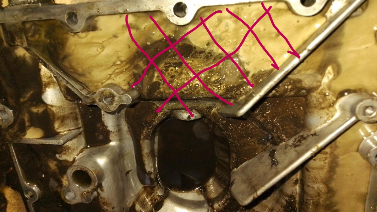

The smart move here would be to drop the oil pan and find the screw and while you have the pan off, clean the oil pump pick up tube strainer. I can't count how many times we've seen pictures of blocked strainers. Once you have the screw frame it and hang it on the wall. Forcing you to drop the oil pan and clean the strainer is "PRICELESS"
I'm betting it got hung up on this shelf
I'll play Don. I'll see your bet of $1 U,S. are raise you $4 U.S. total of $5 U.S. donation to the site. You going to call??
