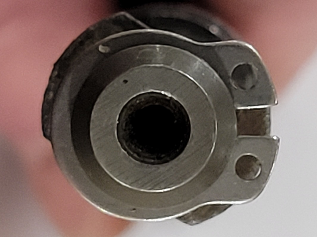

KawBoy comments regarding proper seating, made sure it was properly fit.
Looking closer, I did not like it. Then I went to wiggle on the impeller, it wasn't engaged? Just spinning on shaft.
WTFO?
So removed it and looked closer.
I don't have pics, but the impeller back side has two machined recesses that mate to the shaft. The shoulder on mine is boogered up a bit..
So cleaned it up best I could and reassembled. This time, made sure the tab and slot engagement was good and proper. Not easy for my hands
to push impeller against spring, then wedge it with wood wedges, AND get the circlip on.

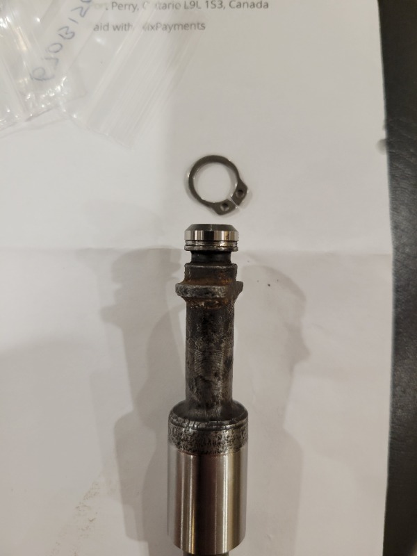

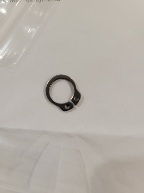

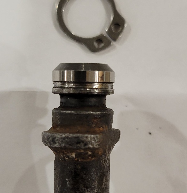

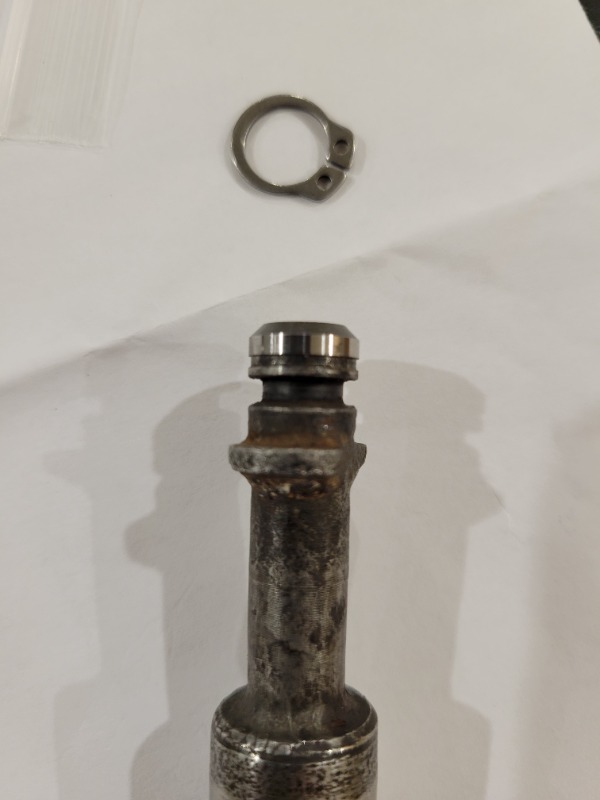

Now, about that circlip- When you have a new circlip sitting in your hand and you look at it, the ears on the circlip are a certain distance apart from each other usually somewhere around .020-.025" and when installed correctly, should look the same and have a very slight grip on the circlip groove but not so tight that you can't spin it in the groove with your finger tip.
What I see in the picture tells me that either the circlip is too small or there is something wrong with the groove. Either the edge of the groove is rolled in or there's a piece of debris in the groove preventing the circlip from fully seating. Whatever it is, you need to figure it out and fix it. I have a set of jeweller's files for cleaning up damaged metal. Another good tool especially for cleaning up circlip grooves is a 6" hacksaw blade from a coping saw. Thin enough for the job.
I figured I needed to support my thoughts with pictures so.......
This is a pic of a brand new s.s. circlip from Zed-parts and as I was saying, you can see the tabs are about .015" apart.

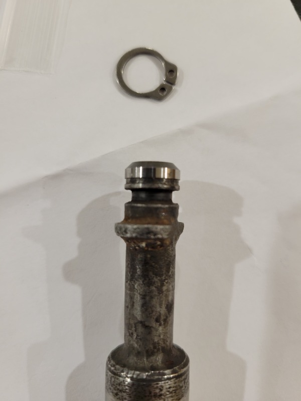

This is the end of my water pump shaft before cleaning the groove there was a fair bit of crud in the groove
After cleaning with a needle file
This is the new s.s. circlip installed on the shaft AND as far as I'm concerned the groove in the shaft is about .010" not deep enough in diameter. I can't spin the circlip on the shaft AND I will fix the depth of the groove before I finish this job. I've run across this kind of issue many times at the plant and I'm sharing my knowledge for your entertainment. Hopefully, people can benefit from what I try to explain. This "stuff" is not common knowledge and maybe only a few "tradesmen" would know the proper fitment of something as simple as a circlip. In nuclear and aircraft mechanics, we all know what happens when the small stuff is overlooked.

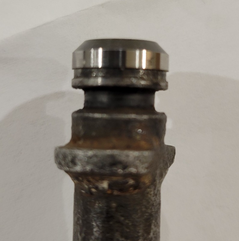

This might be a better pic of before cleaning
And this is after I had cleaned up with the needle file and this is what I had installed the circlip on. Note the ridge at the bottom and top of the groove that probably is still holding up the circlip off of the bottom of the groove. it doesn't take much especially when the groove is so shallow.

"This is the new s.s. circlip installed on the shaft AND as far as I'm concerned the groove in the shaft is about .010" not deep enough in diameter. I can't spin the circlip on the shaft AND I will fix the depth of the groove before I finish this job. I've run across this kind of issue many times at the plant and I'm sharing my knowledge for your entertainment. Hopefully, people can benefit from what I try to explain. This "stuff" is not common knowledge and maybe only a few "tradesmen" would know the proper fitment of something as simple as a circlip. In nuclear and aircraft mechanics, we all know what happens when the small stuff is overlooked."
So took a closer look. KB is right. Check this out.
Fortunately, nothing is buttoned up. Almost looks like the clip is 'sprung'. Will also check the groove like KB suggested.
