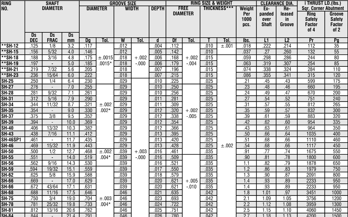

If you care to learn something about snap rings read on. If not you're done.
As a Millwright in the nuclear plant, I got exposed to all sorts of information The "Machinery's Handbook" was our bible. Everything you needed for doing your job could be found in that book. it's about 5" x 8" and about 1800 pages of general info. If I needed to machine a shaft and put a groove in it for a snap ring, all the info required to machine that groove could be found in the book. In this case rather than dig out the book and photocopy the page, I found the same information on a manufacturer's website.
In this case when talking about the snap ring on the water pump I'm going to guess for the sake of using an example, that the shaft diameter for the impeller is 10mm. According to the chart, The snap ring part # would be SH39 The shaft diameter is .394" ( 10mm) The groove diameter is .369" and the snap ring free diameter is .354" diameter. that means the interference fit is .369" - .354" = .015" . So if we "do the math" if we have to expand the ring by .015" diameter ( the difference between the groove diameter and the free ring diameter), then the spread between the ears of the ring would be .015" x π = .047" when installed on the shaft. (Just to give you an idea of what to expect to see if properly installed.)
