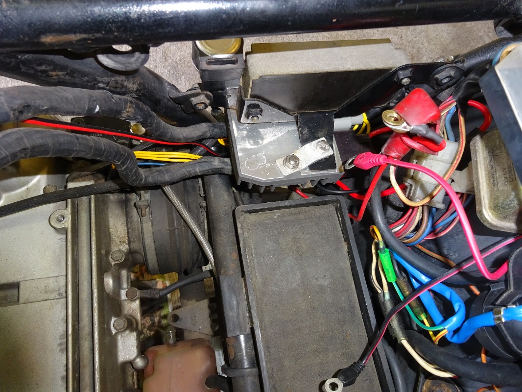

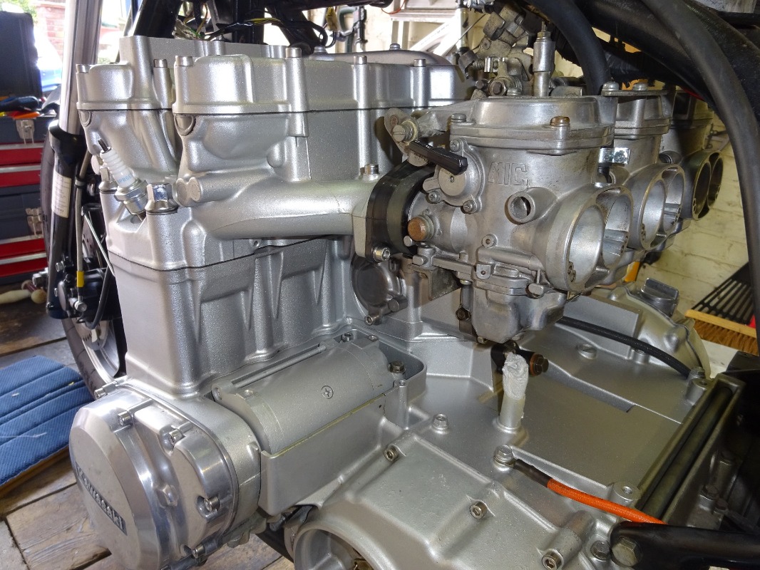

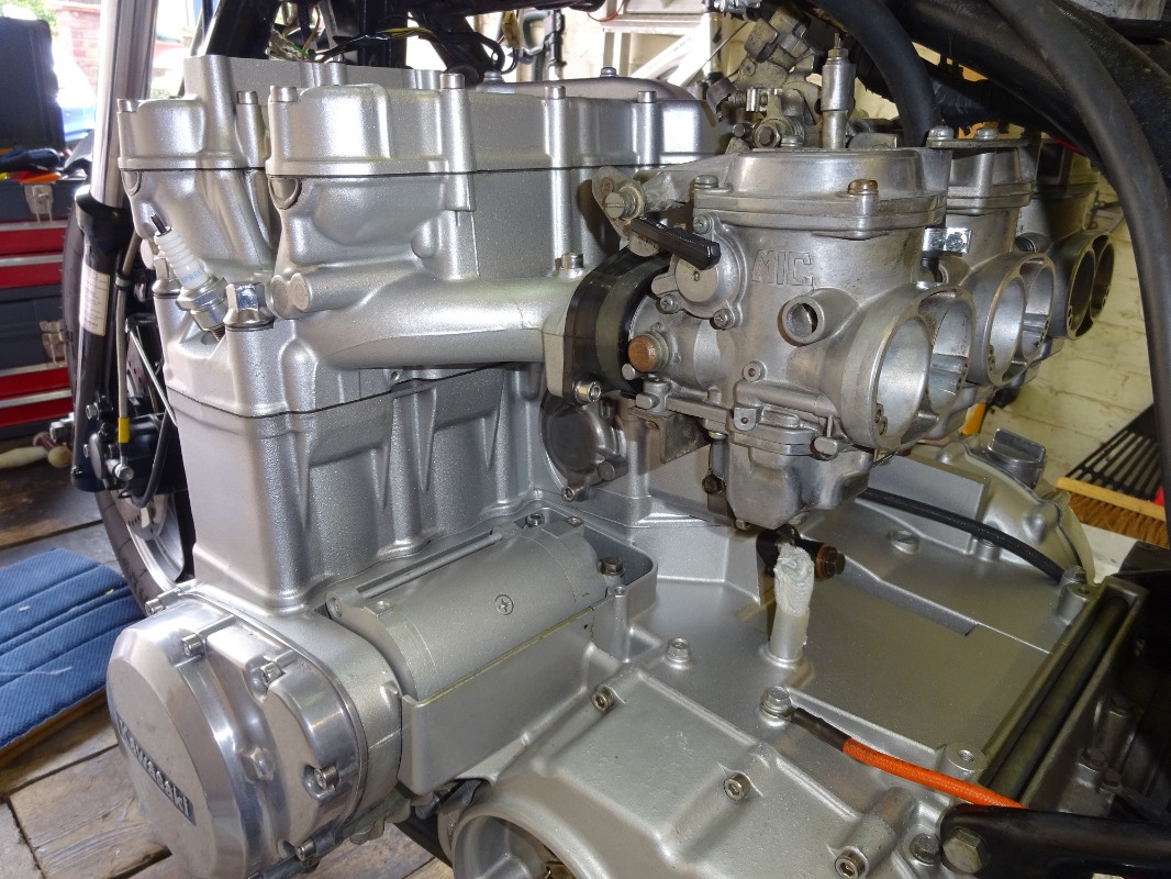

Not sure if this helps but I took some pictures that show the earth cable when I fitted a Shindengen regulator. The airbox and carbs have been removed which shows the earth cable attached to the back of the block, passing under the battery tray and feed up next to the battery on the left of the bike behind the battery.
However, I also have had issues with the earth cable so have fitted a second cable - the orange wire in the pic below. This is connected to the block via one of the accessible crankcase joining bolts on the left side and then feeds under the battery tray as before and up to the battery terminal.
I have also had issues with the original starter motor - sluggish turnover, particularly when hot. I measured the starter motor current (using a current clamp I borrowed from where I worked) to compare with the starter motor specs - turned out that the motor was drawing about twice as much current as it should do due to a short in the windings - drawing more current but producing less magnetic field and therefore torque. When the motor gets hot, the winding resistance increases, reducing the current in the few windings still working normally, resulting in even less magnetic field and lower starting speeds. A new starter motor (some suppliers also offer a rewinding service?) solved the problem inmmediately.
