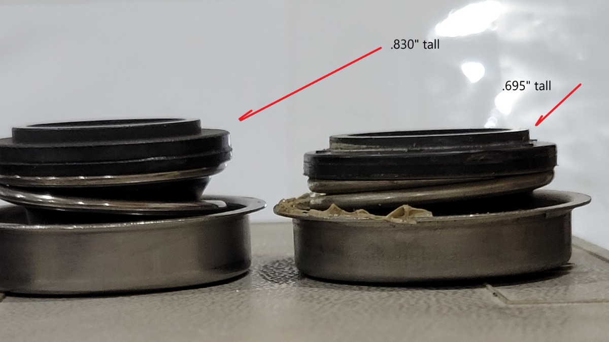

Over the last week I've burned a tank of gas and worn out a pair of shoes going around to 8-10 different water pump / electric motor rebuild shops with seal in hand to try and match it up. On the
ZedParts site (mechanical seal)
there is a drawing of the seal less dimensions. I copied the drawing and added dimensions and along with the seal , went shopping. At one of the shops while talking to the owner, he decided that it would be best if I talked directly to his seal supplier who happened to be a representative for TPG USA, a company specializing in mechanical seals. He spent a whole day on researching and came up with the seal half but needed to have custom seal rings made (the piece that fits in the back of the impeller). I know that it's possible but for only 2 seal rings, probably over $100 to have done.
I had an email conversation with ZedParts and learned that they have had 2 previous batches of 200 seals made up (custom) and just ordered a 3rd batch of 200 seals. At 22 £ a piece ($28 USD) or ($37 CDN) it's a good price all things considered. It's the shipping that stings.
www.z1300.de also has seals available at 41 Euro and that's also a possibility. Not sure about the shipping costs.
At the end of the day, I ordered 2 mechanical seals, 2 lip seals, 2 o rings and 2 stainless circlips for a grand total of 99.70 £ shipping included so I'm all set. One stock cylinder and God willing and I'm able, one cylinder with 66mm custom sleeved bores and pistons. Could be interesting at 1470 cc's

I was previously concerned about the possible height difference between the stock seal and the seal offered by Zed-Parts. When discussing what they had available, they told me that the stock seal as new was .740" tall. I measured my used seal at .695" tall (shorter by .045") Zed Parts seal measures .830" tall BUT it has a softer spring meaning after all is said and done, seal face pressure difference would be marginal. Looks good to me and as previously noted Zed Parts have just had their 3rd batch made up of another 200 seals.
