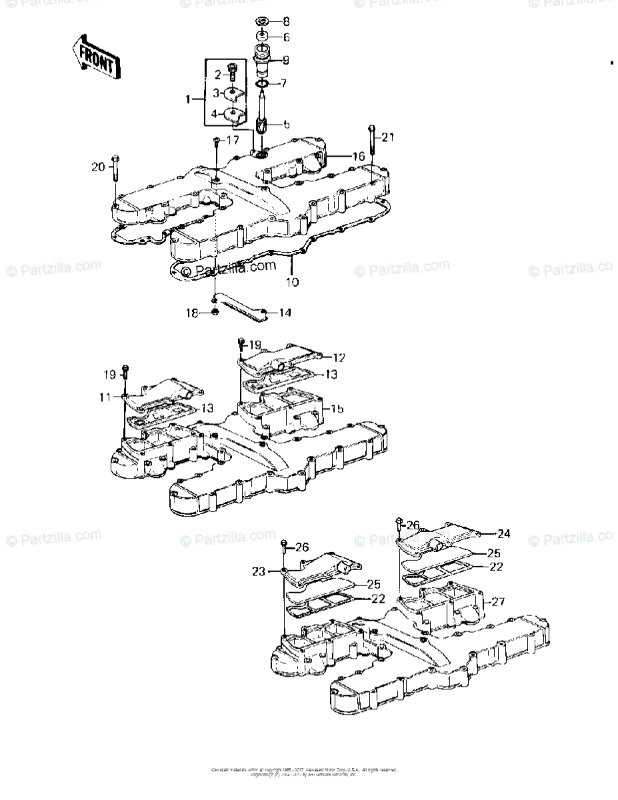

Whenever I'm stumped with questions like this, I go to the parts diagram for maybe another explanation. In this case, the parts diagram shows the tach gear as being installed after the cover has been installed. If the tach gear went in first and then the cover, the parts diagram would show the tach gear below the cover. In this case, the tach gear gets engaged in the spigot in the cylinder head and trapped in place by the Tachometer gear guide item#9. So you'll want to install the cylinder head cover without the tach gear first, then place the tach gear in place then install the tach gear guide.

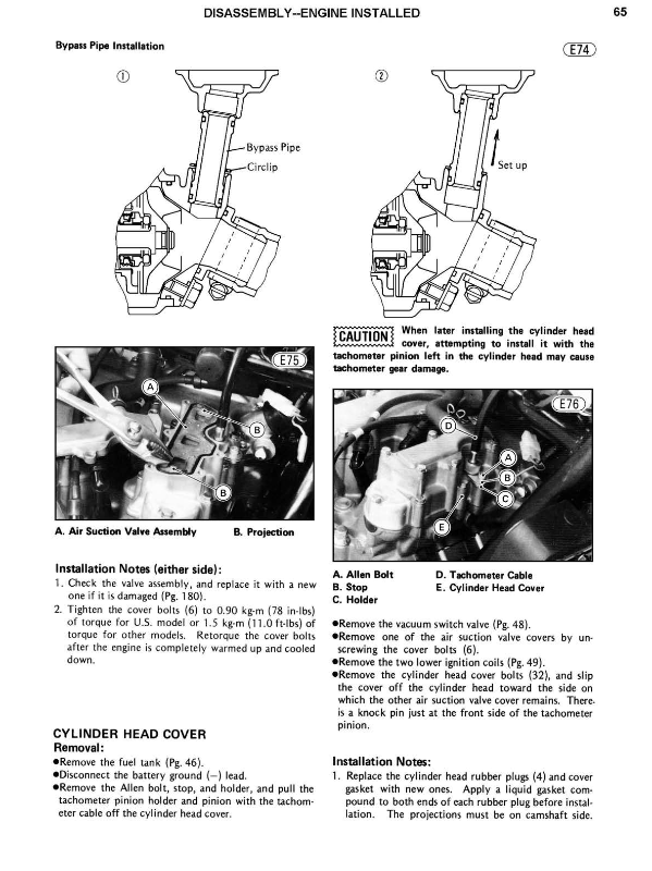

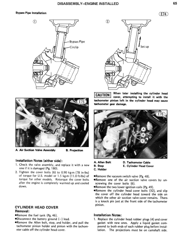

Then there's also specific instructions for the removal/installation of the cylinder head cover in the Service Manual page 65-66 which includes a cautionary note.
