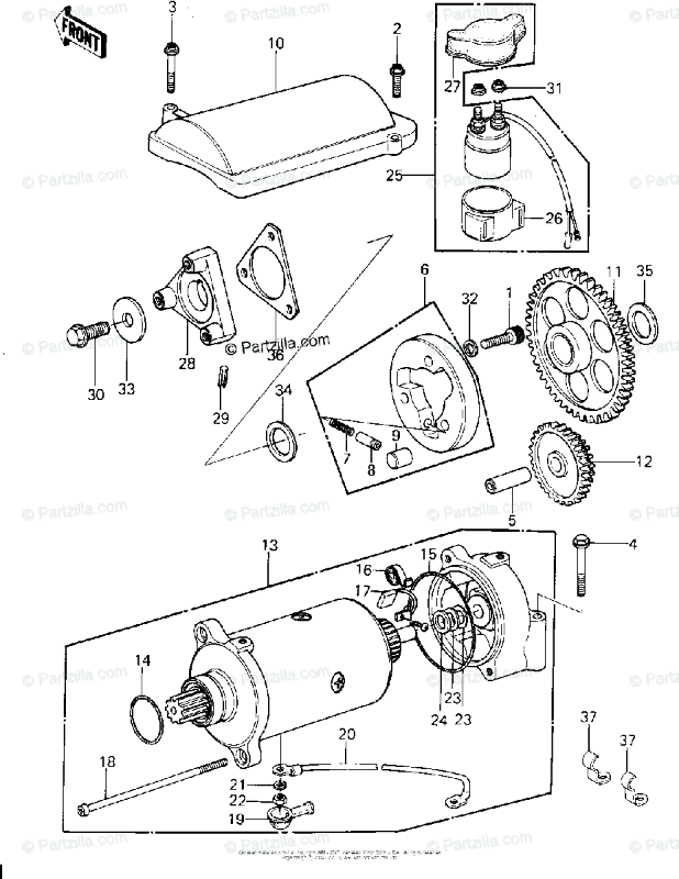

There are 3 allen head cap screws item #1 that hold the starter clutch item #6 to the torsion damper iitem #28 that have a tendency to come loose and have done some significant damage in the past. If the sound is coming from the left cover, that's likely what's happening here.
