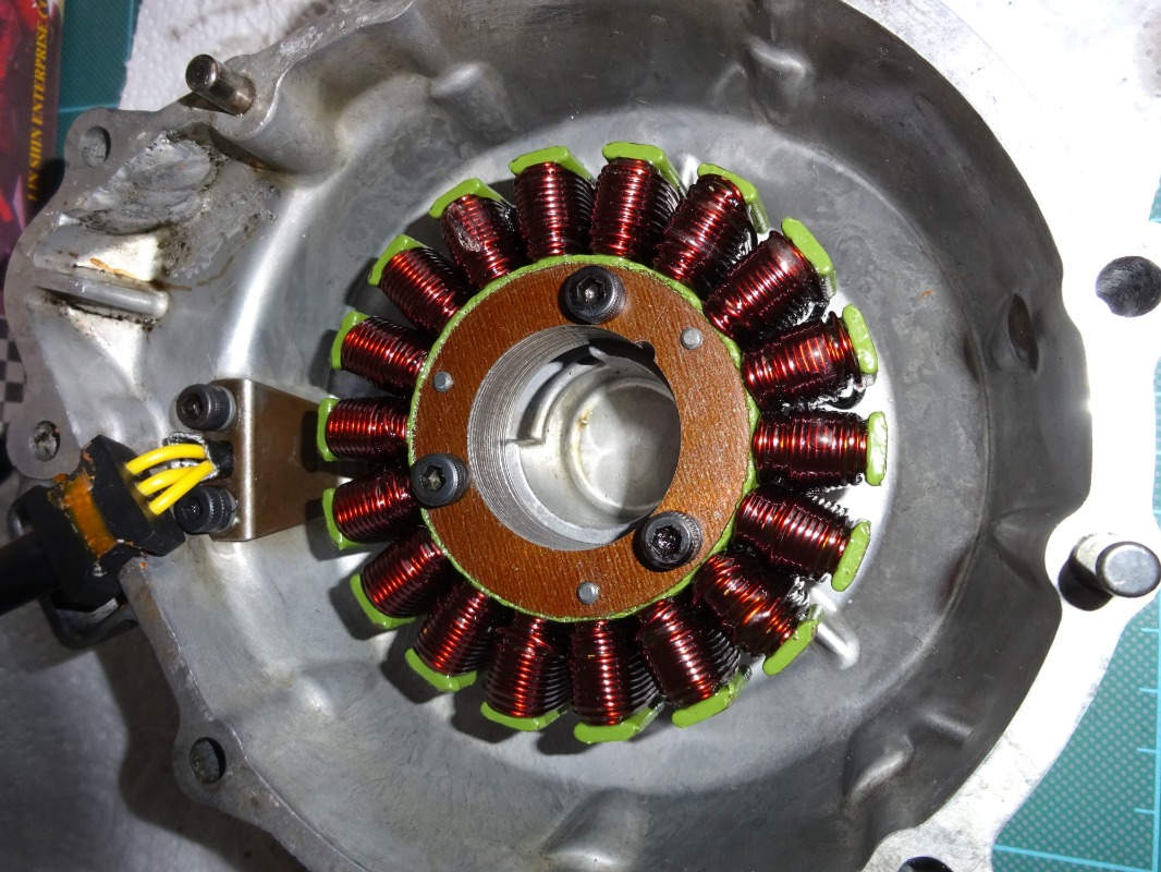

My generator cover cracked as well but I managed to get it welded - just needed a bit of dressing on the gasket face (see pic). However, I've used JB weld in the past - the high temperature version to glue on some cooling fins on the barrel of one of my other motorcycles after I snapped it off when I removed the block from the crankcase. It has proved extremely durable and after filing down, dressing and painting, not even visible. As long as you completely degreased before using it, I would think its probably as good as a metal weld for this type of repair.

Should it break loose, I will look out for the high temperature version. As far as removing the internal components in order to weld, do you just remove the 5 screws (2 for the wire and 3 for the... coils) in order to separate the 'guts' from the plate? I've removed the plate before (to look for the source of the oil leak), but always left the wires attached.

Yes, just the 5 allen bolts - the plate keeps the wires away from the rotor attached to the crankshaft. After removing the bolts, pull the rubber grommet out from its channel to release the whole assembly. Important to use some liquid gasket around all of the sealing faces of the grommet when reassembling or it will leak oil.
