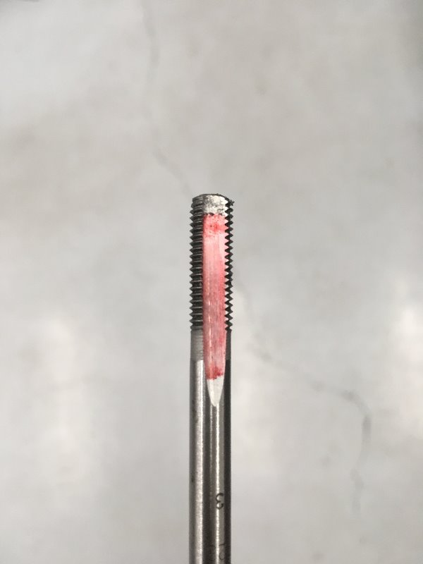

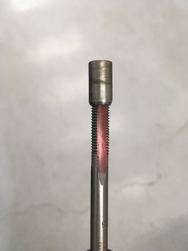

If you have a dowel-pin that is difficult to remove I found that a 1/4-28 (or similar) TAP, will turn in a few threads and pull these pins. Pliers will deform and gouge if too much pressure is applied.

Just add some clarity to the removing of dowel-pins. The intent is to fit an appropriate size tap that "Just" starts to thread in. Used a Red marker to show the how little it takes.
