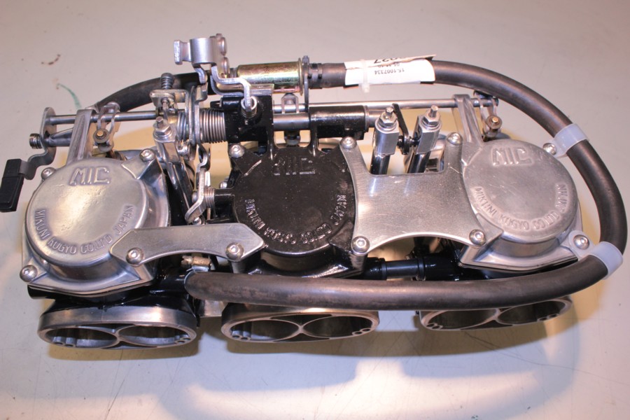

It looks like my fuel solenoid went kablooi (that's American for 'broken') on my '81 A3.  I now have the 3/8 fuel line routed directly to the carbs, but, there's no room for a standard fuel filter available locally.  I haven't seen any on-line that I think will work.  Does anyone half a recommendation?  I can route the line under the carbs similar to the original configuration which will give me room, but obviously don't want to hinder flow.

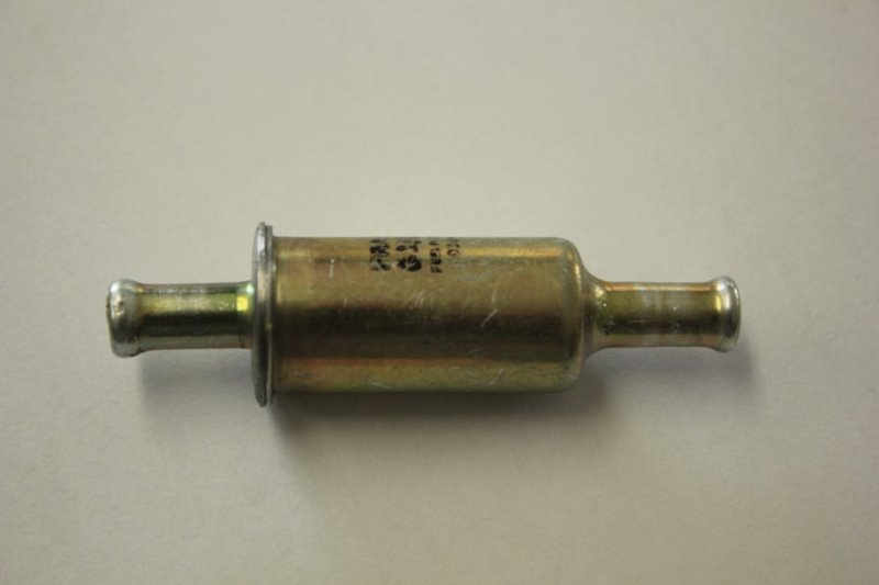

After rebuilding I configured two sets of cabs like this, for a 1300 owner
 WIX # 33027  used these for years.  Don't let it's size fool you.
Last edit: 5 years 1 month ago by scotch.
The following user(s) said Thank You: dcarver220b, zed_thirteen, Ted
  • dcarver220b
  • dcarver220b's Avatar
  • Posts: 1324
  • Thanks: 307
Re: Solenoid Removed, Seeking Fuel Filter Recommendation
5 years 1 month ago
That's a clean install Scotch...

The fuel filter for a '77 Datsun/Nissan 620 pickup (2.0 liter) may be helpful. It's a cylindrical body with the outlet perpendicular to the body. The inlet is on the long axis. The filter element is high-capacity paper, and some manufacturers' parts use a clear plastic filter body, as I prefer.
