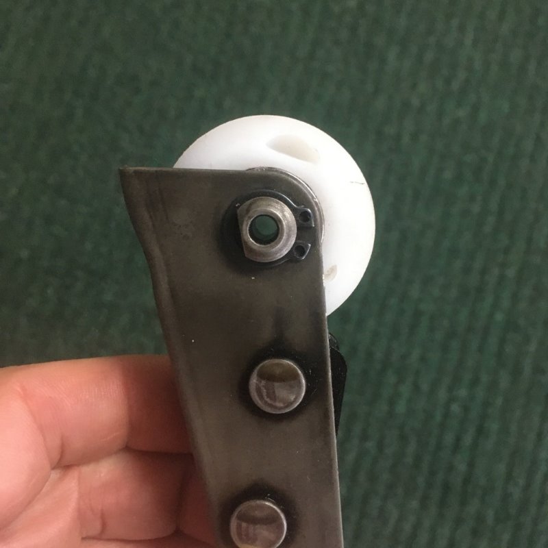

I asked how he would fashion one: "Yes I would press a bearing into it. It would look like the KZ650 roller I sent you a picture of. Metal hub with a plastic outer ring bolted in between".

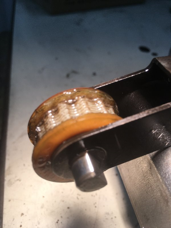

This is from other Kawasaki's
This is what Gordon would make

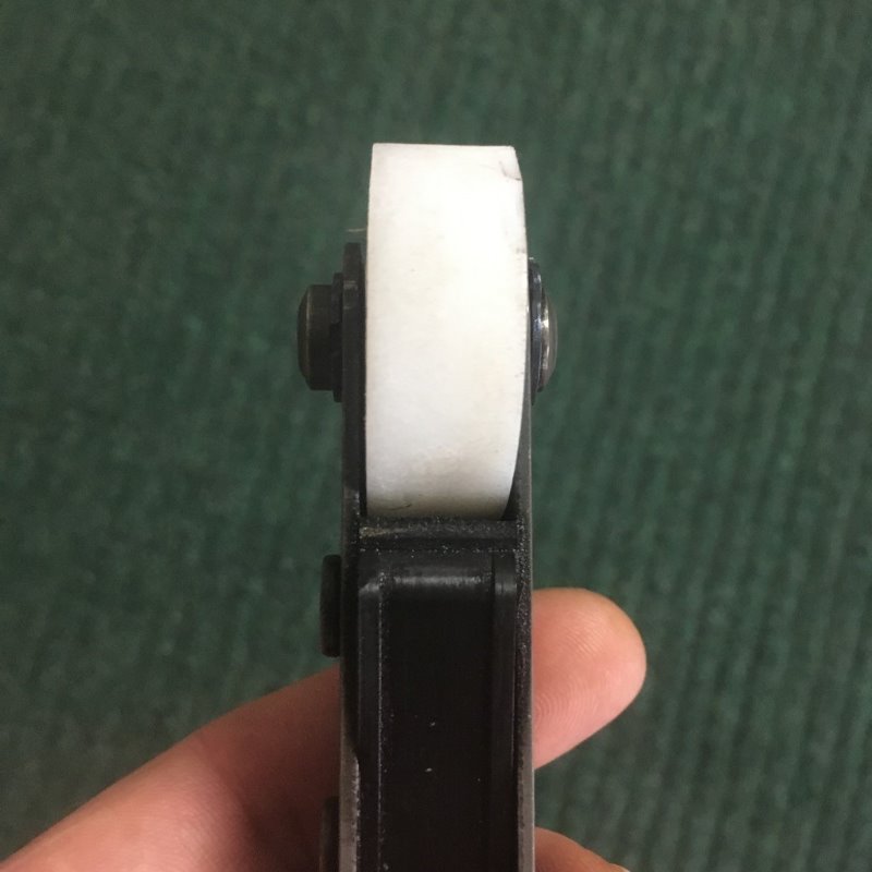

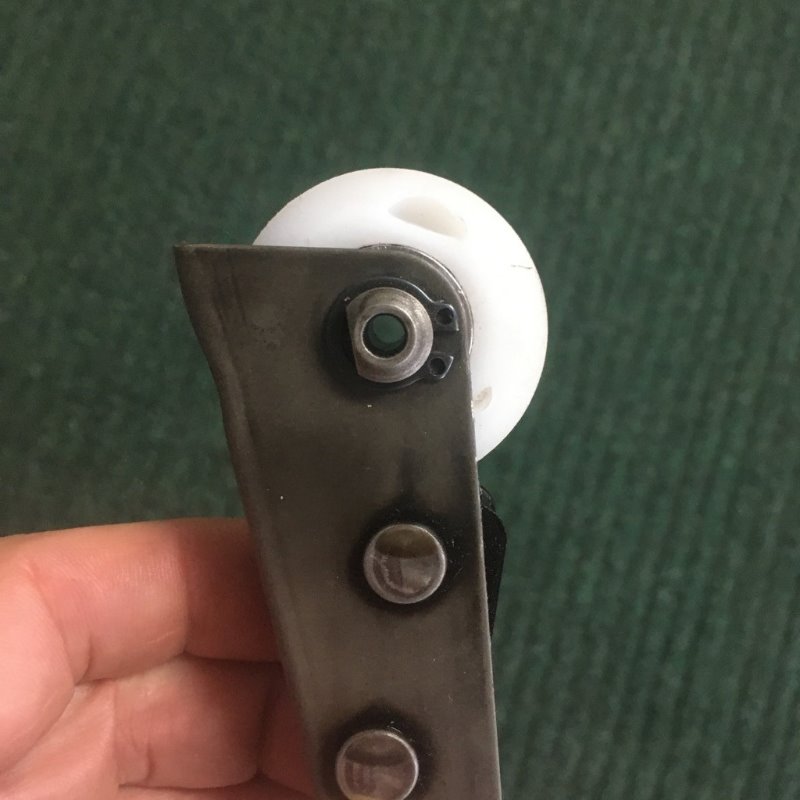

This my mock-up using Nylon

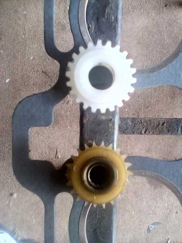

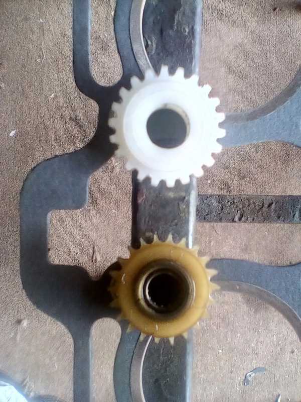

This is a new tensioning sprocket from Kawasaki purchased 4 years ago
It's a nylon sprocket and it would have a J78 bearing press fitted in to it directly, so I see no reason why a Nylon or Delrin tensioning roller couldn't be made up in a similar manner provided the correct interference was maintained. My only concern would be lateral tracking due to a loose chain if the chain tensioner was a manual tensioner and not spring loaded. So bearing that in mind, I would probably machine a couple of vee shoulders on the outboard edges just to ensure that tracking was accounted for.

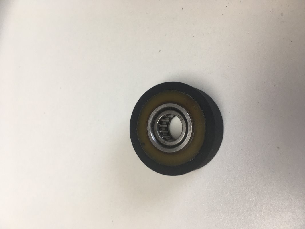

This is the KZ1000 tensioning roller I believe.
It's a nitrile roller vulcanized on to a steel? bushing. As I remember it, the roller is 46mm in diameter and the bushing is 13mm ID. so if the bushing could be machined out to the od. of the J78 bearing less .002" and a J78 bearing pressed in, then machine down the od. of the nitrile to 35mm, we'd be in the money. I can envision clamping the roller down to a drill press table and drilling/reaming out the bore. It would be delicate but doable. and machining down the roller diameter while locating around the bearing. All doable but definitely time consuming.

I settled on this: The core is my OEM Sprocket

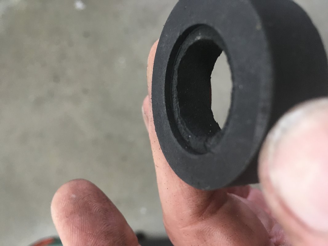

Ended up with a suitable rubber wheel, after 3 "prototypes"
Used JB Weld Pro epoxy to bond the two.
