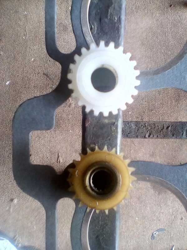

Holy Crappers Scotch. you turned an "outtie" gear to an "innie" gear.
the top gear in pic is a brand new Kawasaki tensioner gear
The bottom gear is a tensioner gear that came out of my KZ1300 at 42K Km.

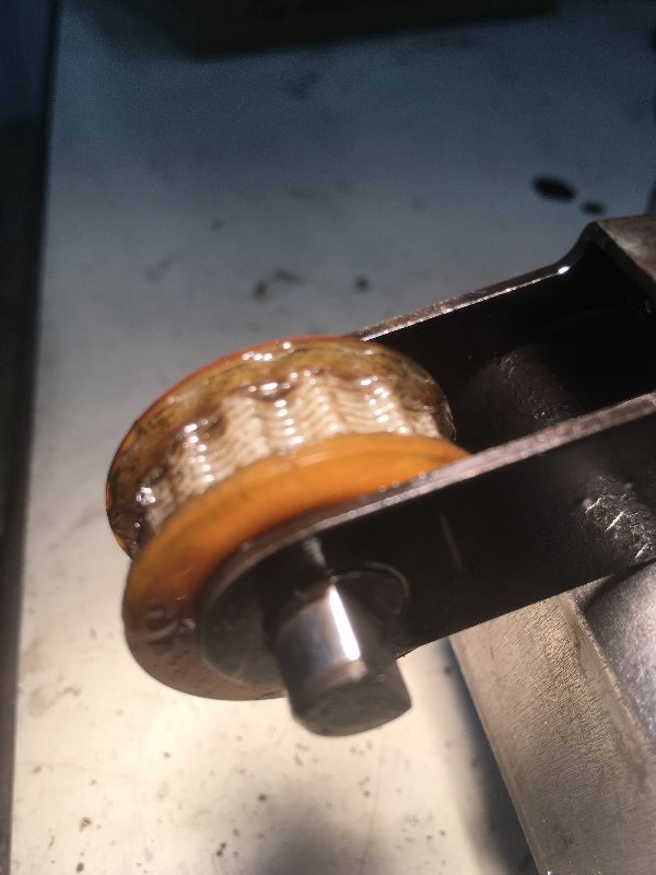

Is this from your bike scotch? Did you mention a while back that you intended replacing this sprocket with a steel alternative?

I've been putting off replacing the sprocket for the past several years but it's worn-out now. This year I noticed a "lack of enthusiasm" from the throttle. Rings-n-valves, now, as well.
Cylinders glazed like mirrors! No scratches or flaws. No ring-ridge. Piston-domes are pretty sooty but otherwise in excellent condition. Valve-stems have some coke build-up.
Having the cylinders done properly at a machine shop. Hoping a precision honing will be all that's required but have a "Plan B" if required. Will have to see what lapping accomplishes. I don't want to start cutting seats and grinding valves only to end up in the nightmare of not having enough clearance for even the thinnest shims.
