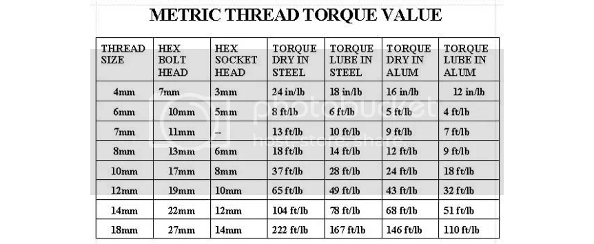

The Machinery's Handbook
may be a little much for the average Joe to have in his library, but it's in mine. Full of all kinds of information regarding machining practices, fits and tolerances. So in lieu of this , here's a snap shot from
www.classicmotors.com
of a torque chart for different metric fasteners.
