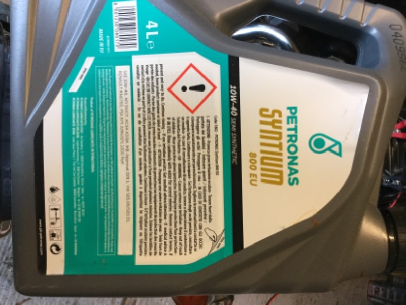

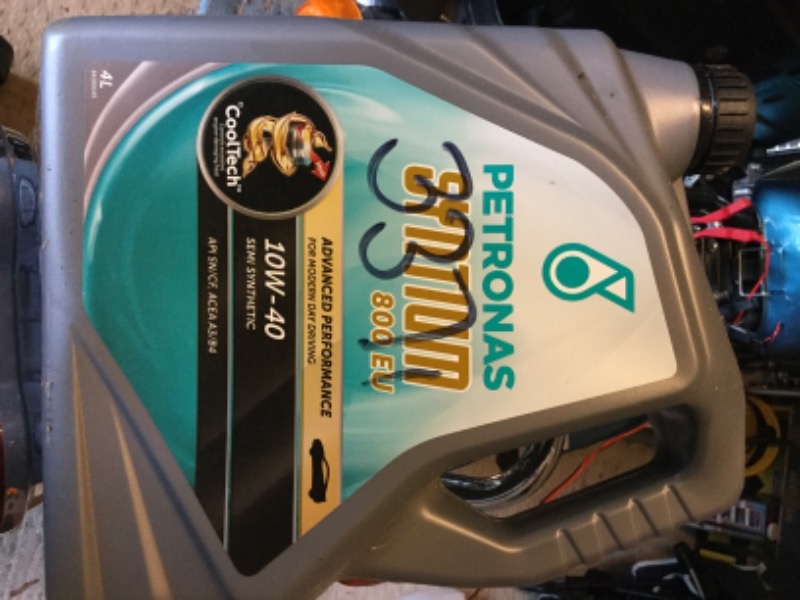

Just going to throw a spanner in the works for the purpose of debate. I’m currently using this make of oil in my bike with no issues whatsoever. The bike gets used regularly during the summer months and isn’t due an oil change for another 500 miles. However, the bike hasn’t been used for the last 6 months due to being in storage over the winter so the oil is technically over 18 months old. If we are led to believe what the manufacturers tell us I should be changing the oil now as the oil breaks down over time even if the bike is not being used.

If the oil has been in the motor that long without use, I personally would change it regardless of what manufacturers tell us.
It may have levels of moisture in it now which can be accumulated by varying temperatures over the storage time.
If however, your bike is kept in a steady warm environment all the time, then the oil should be ok for use.

Hi Pete,
The bike is indeed kept in a warm garage and will be getting an oil/fluid change before I take it out again. Thanks for the warning and I’m sure this will open up the debate further.
