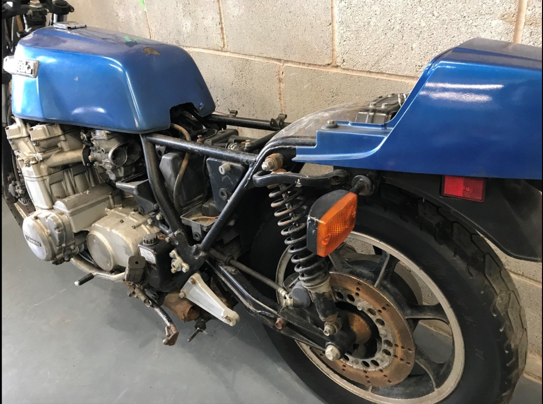

6 years 6 months ago - 6 years 6 months agoscotch wrote: Pictures might help answer the other questions
Myeah, point taken. I have no pics of the hoses yet, but here is a pic of the bike as bought and you can see one of them going from underneath the fuel tank to the water reservoir...
You can also see there is no fuel vent pipe...
The other rubber hose is identical, shape, size and length.
