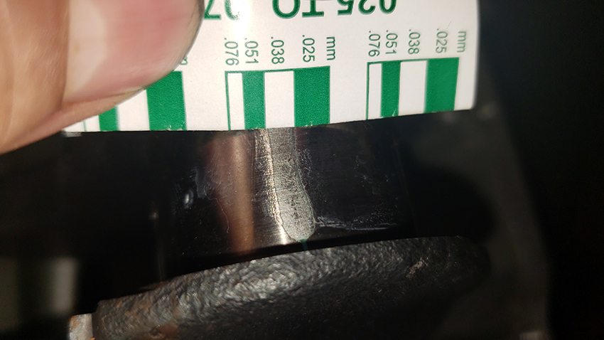

I bought crankshaft journal bearings according to markings on the crank case and the crank shaft (both are from different engines). I chose these bearings following a table in the manual, and were 'black' in my case.
Next - used plastigauge to check the clearances. I think this is the best direct method to see what is happening. In my case, the clearances were 0.038 mm in all except one, which was about 0.043 mm in my estimate (stator side).
The service limit per manual is 0.1 mm (and connecting rod big end 0.1 mm as well). Having my clearances measured using correct and new bearings for this particular crank case and crank shaft pair, considering that the crank shaft is not new and hypothetically worn a bit (looks smooth and nice), the conclusion for me is these clearances are about what correct clearances should be, and there is still lots of life for this engine.
