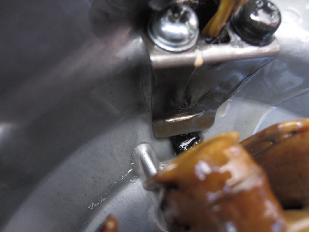

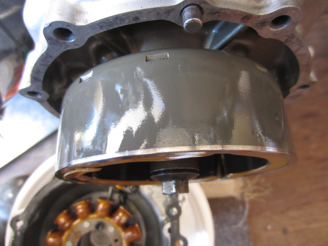

Gents, thanks for your input…
I was primarily thinking it was a cam chain problem myself, but after a lot of head scratching…
I remembered that the bike has a nonstandard alternator stator which is 2 phase system and perhaps, may differ in size and shape from the original.
As soon as I removed the alternator cover I could see that the outside edge of the rotor had been in contact with something.
It turned out that this was rubbing on the bottom of the stator wire retaining clamp where the shortness of the wiring loom has pulled the clamp out into the path of the rotor.
Normally, the wires are long enough but when you remove the rubber sealing grommet to apply sealant – this pulls the wires up and forces the clamp outwards…
Lessons learnt – Ha, don’t drink beer and listen to loud music when you are working on your bike!
Secondly, check that after you have re-sealed the wire grommet into its slot, the wiring loom containing the stator wires has not pulled the bottom of the clamp away from the cover…
I am not 100% sure that this is the cause of that noise, but before road testing it to find out... I also noticed that the yellow rotor edging has broken and is coming away - I will try to glue that back into place first (if that is possible).
